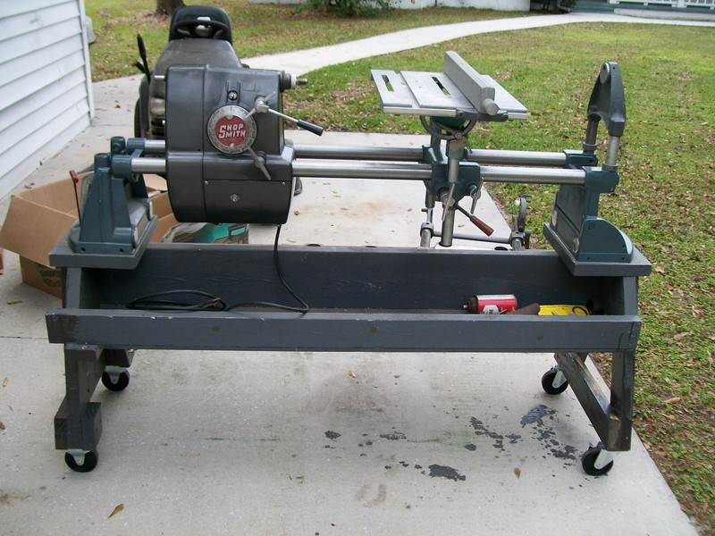

Ed in Tampa wrote:I hope Bill Mayo chimes in. He has a contractor ShopSmith made especially for taking to the job site.

mbcabinetmaker wrote:I have needed to take my 510 to several job sights lately. I am trying to come up with some way to transport it over rough terrain from my enclosed trailer to the job sight. The factory casters are great for concrete floors but not any help for good old uneven ground, rough asphalt or even muddy freshly graded job sights. I plan to leave the casters in place and do not want to add to the over all height. Put on you thinking hats!:)

Isn't Bills machine a wheelbarrow front end with handles at the rear? Looks real useful.

jm51 wrote:Isn't Bills machine a wheelbarrow front end with handles at the rear? Looks real useful.
I think Hardly knot! It's more a bench with wheels on one end and a tow hitch on the other end.
My construction Shopsmith is pictured above. It was moved to job sites on a tillable trailer. I used a 2 KW invertor for power. Since I quit going to jog sites, I removed the 10" wheels and trailer tongue and mounted 4" casters at each end. This is now my primary Shopsmith. It has a reversible motor now.
