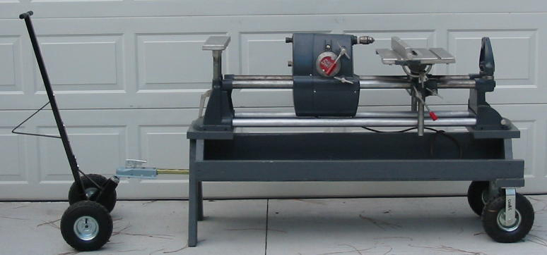

I have needed to take my 510 to several job sights lately. I am trying to come up with some way to transport it over rough terrain from my enclosed trailer to the job sight. The factory casters are great for concrete floors but not any help for good old uneven ground, rough asphalt or even muddy freshly graded job sights. I plan to leave the casters in place and do not want to add to the over all height. Put on you thinking hats!:)

mbcabinetmaker wrote:I have needed to take my 510 to several job sights lately. I am trying to come up with some way to transport it over rough terrain from my enclosed trailer to the job sight. The factory casters are great for concrete floors but not any help for good old uneven ground, rough asphalt or even muddy freshly graded job sights. I plan to leave the casters in place and do not want to add to the over all height. Put on you thinking hats!:)
This is not mine... Someone posted it and I saved the picture just to keep the idea in my head. As I recall the "hitch" removes by pulling one pin.
I really liked the idea.
[ATTACH]15929[/ATTACH]
I have one of those "trailer dollies" already that I use on a camper.
Construction site Shopsmith.jpg (73.15 KiB) Viewed 8776 times

Make a platform on inflatable tires like Farmers pic. Roll it under the SS where the storage shelf would go and have it lift from under the tubes.
A "pallet jack" sort of deal.

mrhart wrote:Make a platform on inflatable tires like Farmers pic. Roll it under the SS where the storage shelf would go and have it lift from under the tubes.
I think you are on to something here. Although I like the Farmer/Mayo cart I would like to keep mine on the original legs and casters for when I use it in the shop. Lifting from the bottom of the tubes would also help with the unit being top heavy.

Maybe you could slide the "jack" under from the side, but I think to pull the SS around and up into a trailor or through a doorway on a jobsite, it would need to be pulled from one end.

I was leaving a home depot store recently and saw a fellow had a table saw mounted on an angle iron frame that allowed the base under the table saw to sit an inch or two above the ground and on each end had what appeared to be small bicycle wheels mounted on axles that were high enough that he only had a couple of inches clearance from the ground but those huge wheels would give him ability to roll the thing anywhere. It reminded me of Bill Mayo's cart and explanation of the bigger wheels being required for uneven or porous surfaces like gravel. When we moved from Virginia I built an overgrown furniture dolly to size of shopsmith. It had only 5" wheels and did not work well in gravel. Jim

I hope Bill Mayo chimes in. He has a contractor ShopSmith made especially for taking to the job site.
