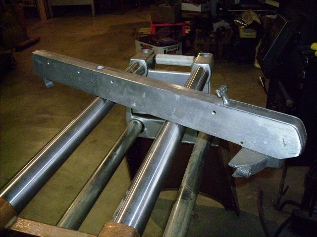

JPG40504 wrote:Tapped holes in a MVII fence? Curiosity is greatly 'aroused'.:confused:
I just went down and took a picture of the Mark VII fence to show the tapped holes. There are 4 of them along just below the top. They are 5/16"-18. The fence walls at that point appear to be between 3/16" to 1/4" thick. They appear to be drilled through both walls at once and tapped. I can't say without trying it and I don't have bolts and stuff moved in yet but I feel pretty certain that they were through tapped all in one operation and that a bolt started in one side will thread right on through both walls.

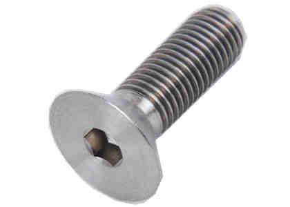

I'm pretty sure that you could attach a fence with countersunk bolts going through far enough to add a lock-nut (or self locking nut) gently tightened on the back side.
Bolts like this in the needed length.
[ATTACH]16043[/ATTACH]
temp countersunk bolt.jpg (7 KiB) Viewed 2272 times
Shopsmith Mark VII fence.JPG (83.51 KiB) Viewed 2271 times
robinson46176 wrote:I just went down and took a picture of the Mark VII fence to show the tapped holes. There are 4 of them along just below the top. They are 5/16"-18. The fence walls at that point appear to be between 3/16" to 1/4" thick. They appear to be drilled through both walls at once and tapped. I can't say without trying it and I don't have bolts and stuff moved in yet but I feel pretty certain that they were through tapped all in one operation and that a bolt started in one side will thread right on through both walls.
What is the hole spacing? 7 1/4, 3 5/8, 3 5/8?

The countersunk bolts used with the table insert will work with Shopsmith's T-nuts in the 520 fence side slot. The "help kit" contains a couple extra of those countersunk bolts.
Gary
greitz wrote:The countersunk bolts used with the table insert will work with Shopsmith's T-nuts in the 520 fence side slot. The "help kit" contains a couple extra of those countersunk bolts.
Gary
So you telling me the 520 side slots are t-slots the same as the two top ones? That changes most of what I have posted re drilling holes in a 520 fence. No need to do that!
