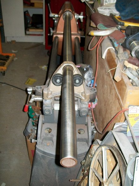

The most handy addition for my Shopsmith was for sanding, polishing and waxing the way and bench tubes. It also is a way to detect bent tubes. I have done several hundred tubes using a 3X21 belt sander with various grits.
[ATTACH]16134[/ATTACH]

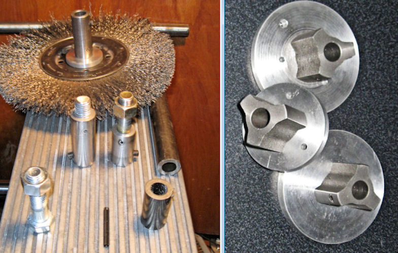

arbors and faceplates:
[ATTACH]16150[/ATTACH]

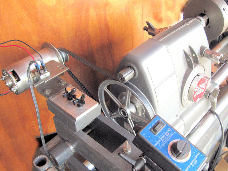

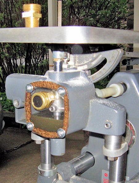

aux. motor drive (poor mans speed reducer)
[ATTACH]16151[/ATTACH]

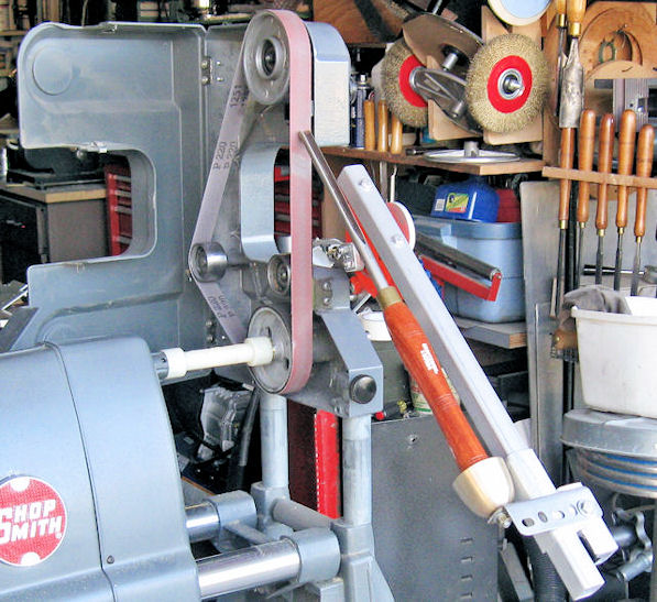

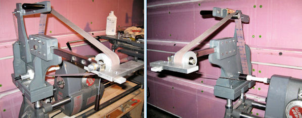

chisel sharpening jig
[ATTACH]16152[/ATTACH]

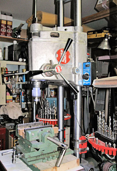

dedicated drill press with dc drive
[ATTACH]16153[/ATTACH]

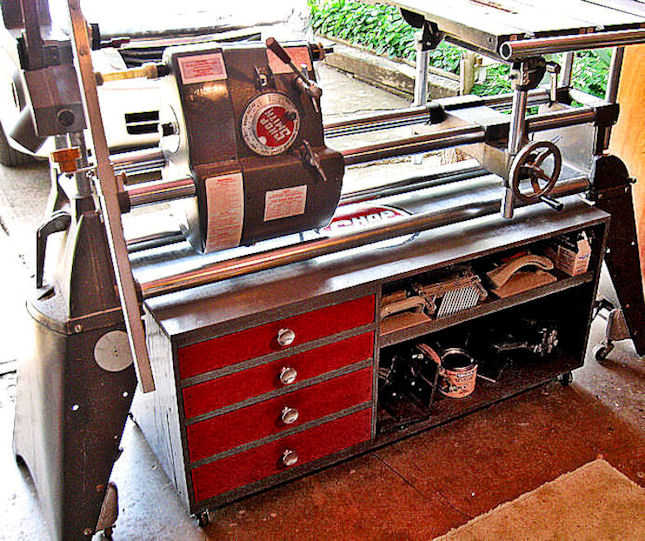

storage unit under SS
[ATTACH]16154[/ATTACH]

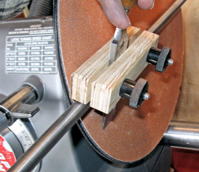

home made version of strip sander chisel sharpener
[ATTACH]16156[/ATTACH]

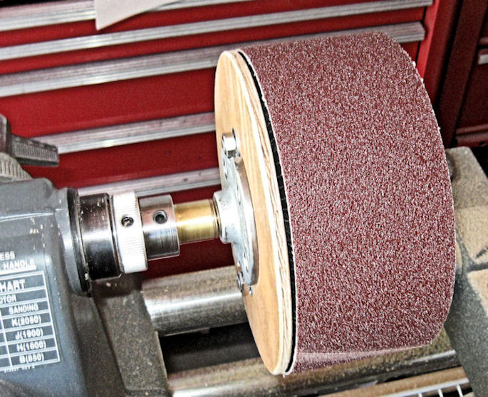

[ATTACH]16157[/ATTACH]
window added to jig saw
inflated drum sander

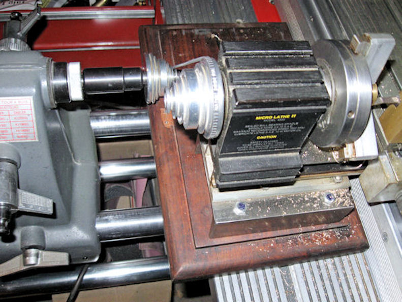

Taig metal lathe driven by the SS
[ATTACH]16159[/ATTACH]

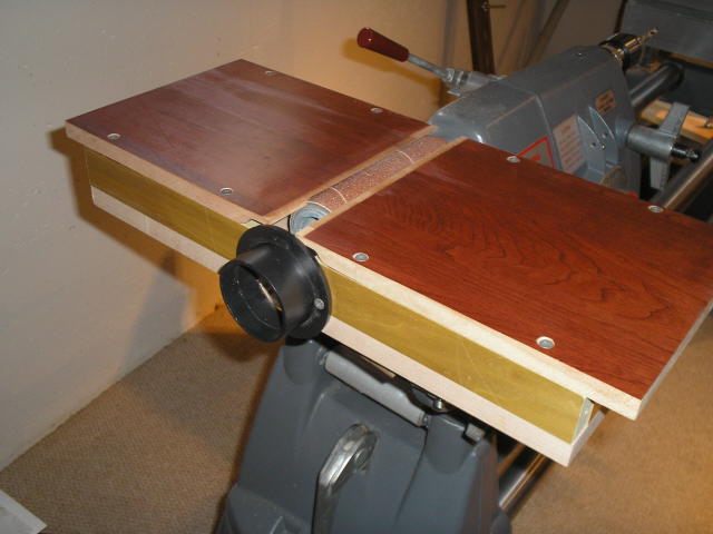

Poor-Man's Sand Flee
This one inspired by Reible a few years ago:
[ATTACH]16161[/ATTACH]
[ATTACH]16160[/ATTACH]

I'm assuming that you used a CNC machine for the faceplates. If you used the SS let me me know how because I would like to make some for myself.

Nuhobby i take it that one end of that table would be at the same height as the top of the roller to make it all work?
Since I have the strip sander im going to try to get a jig going for doing all my chisels. I like your ingenuity!!
1992 SS MarkV with bandsaw, stripsander and ring master...
- Posts: 35598
It is not a jointer, it is like a sand flee. The table surfaces are essentially co-planer(not all that precise) and are adjusted height wise to be just below the top of the drum(minimal material removal).gucho wrote:prmindartmouth :
Objective is surface finish, not dimensional control.
