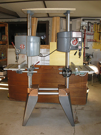

My biggest mod is my Push me - Pull me (as in Dr. Doolittle) double drill press. I am quite pleased with it.
[ATTACH]16131[/ATTACH]
It is now on a caster set but I still have more things to add to it. I wanted to be able to set it up with something like the mortising set or other setup and leave it undisturbed if I needed to drill some holes. It also pretty much saves me from the expense someday of a lift assist kit since I am unlikely to ever need to raise any of my other SS's to vertical.
It is still to get some small pulleys, cable and weights to make it easier to raise and lower the headstocks and tables. It is also getting on-board drill bit and accessory storage.

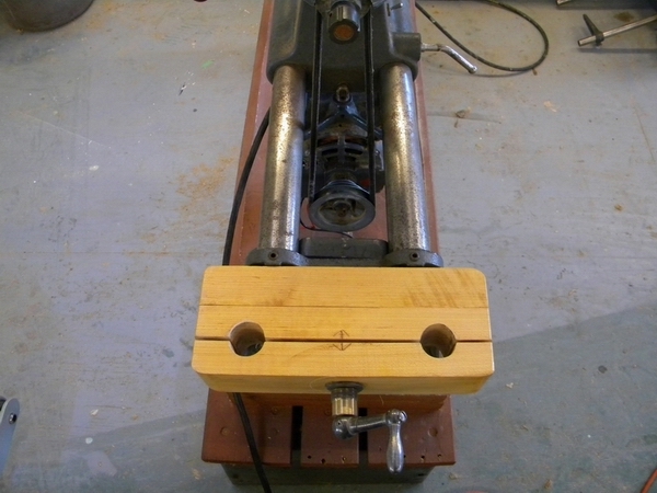

and here's the SPT mount
[ATTACH]16133[/ATTACH]
