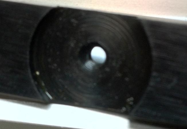

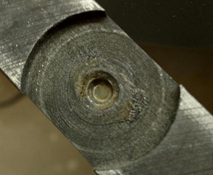

Well the jury is no longer out. Without question, the mystery material in my miter bar was a previous owner's repair.
Here is the old miter bar, front and rear, showing the mystery material.
[ATTACH]16535[/ATTACH]
[ATTACH]16534[/ATTACH]

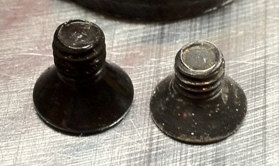

I received my new miter bar today and there is no mystery material or other insert in the miter bar. As can be barely seen in the photo, the threads are cut directly into the miter bar.
[ATTACH]16532[/ATTACH]
In addition, when I compared the screw from the new miter bar to the old, the old screw is shorter, which I suspect means part of it was sheared off.
[ATTACH]16533[/ATTACH]
I believe the mystery material in my old miter bar was probably epoxy put there by the previous owner after stripping/ripping the screw out of the miter bar by putting too much stress on the washer.

Here is my $.02 since you said you feel the miter bar is too short for a sled.
Now that you have the NEW miter bar....I would drill out the mystery hole in the old miter bar and tap the next screw size up (#10).
Then replace the original 8-32 screw with a 10-32 and you have yourself a new usable miter bar...
Just thinking out loud ;)
Geo
[quote="eagleta2"]Here is my $.02 since you said you feel the miter bar is too short for a sled.
Just thinking out loud ]
And if the head on the 10-32 screw is too thick, it can be filed/ground down.:)
