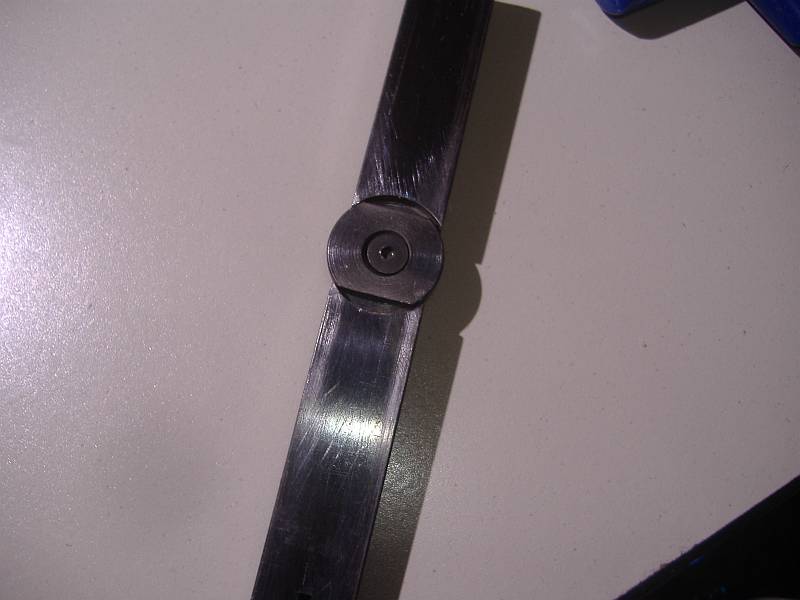

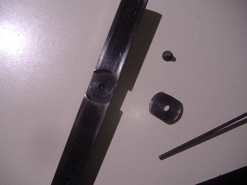

Dusty here is something I posted here a very long time ago that makes the washer/non-washer miter gauges interchangeable. The washer is trimmed then you either turn it so you have no protrusion ie belt sander/500 table/cast iron bandsaw or turn it so you have the protrusion for use on the newer equipment.

That is a neat solution to a possible irritant. I may have to do the same thing for the miter gauge that I use on the belt sander. Thanks Ed.
