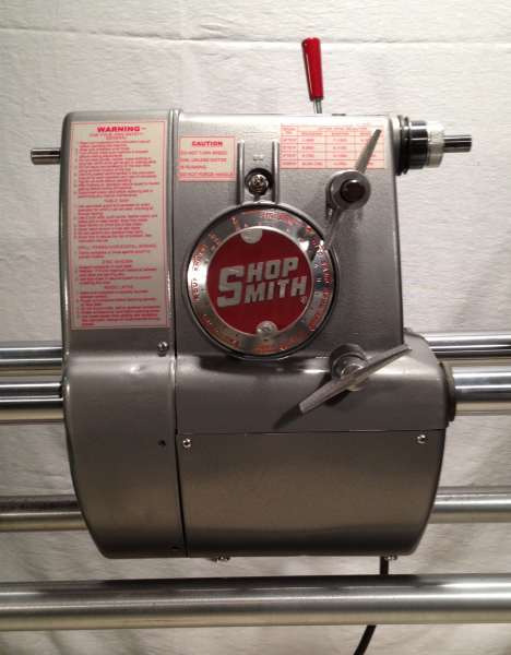

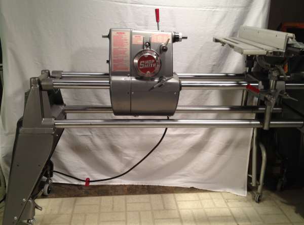

I wanted to post the pictures of the final product before I started in on my new project.
[ATTACH]18359[/ATTACH]
This is the headstock. It's not the original red A casting. That is now in the hands of one of our members. He did not tell me whether he was going to repaint it or not. This is a B casting I got off eBay. This is not the original speed control dial. It had a casting fault on its back side.
[ATTACH]18360[/ATTACH]

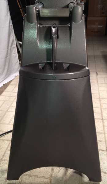

These are the legs. They are the originals after sandblasting and painting.
[ATTACH]18361[/ATTACH]

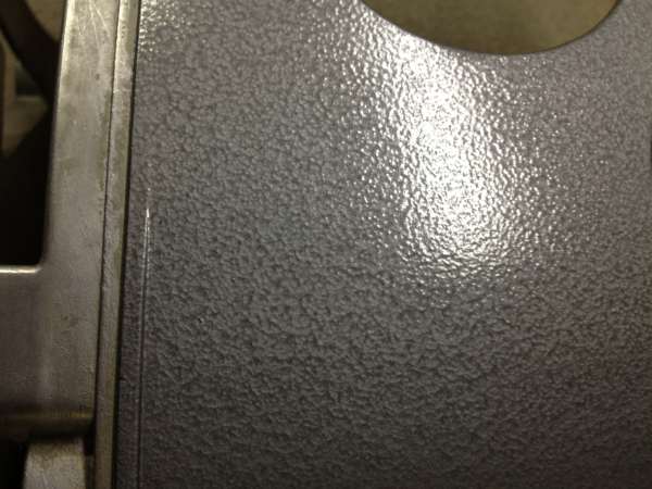

I used Rustoleum's Hammered Gray paint. This is a close up of the headstock.
[ATTACH]18362[/ATTACH]
Because of my next project I will convert this to a shortie or minnie.

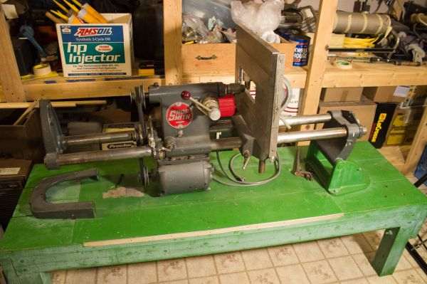

This is my next project. It will become my dedicated drill press.
[ATTACH]18364[/ATTACH]
Although its next destination(function in life) is unknown at this time, it will definitely NOT retain its current color or paint.:rolleyes:
Nicely done!!!!
Very nice next project!

I forgot to mention that I converted to a poly drive, installed new drive bearings, and had new bearings installed and bad wire insulation repaired on the motor. This latter was about $140. Also put on bigger wheels (not SS)(rolls really nicely). Things appear OK except for a short ratchet sound when I turn it off. Oh, and I installed a new power switch (Bill Mayo's recommended model).
I was toying with converting my motor to a reversible until someone pointed out the motor shaft spring keeper on it could spin right off while running (LOOK OUT!).

nuhobby
Posts: 2366
Location: Indianapolis
Post by nuhobby »
oddie wrote: Things appear OK except for a short ratchet sound when I turn it off.
Likely not to worry :D . If you watch official Shopsmith "Sawdust Sessions" on YouTube, etc., you can hear this sound on a new machine. I think it's a matter of a transient condition during shut-off. Upper (Poly V) belt then is tight while the lower (motor) belt is relaxing. This puts a slight uneven pressure on the idler bearing which then knocks.
I used to have this noise in my newer machine before I went Power Pro.
