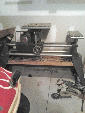

Hi,
Looks like a step by step might be in order here.
1) I would start by taking the rip fence off. The rip fence has a lever which locks the far end to the table, the wingnut part on the front needs to be loosened and the lever up then slide to the left. This is the part you have labled "A". Store it for later.
2) Remove any loose parts that are just sitting on the top of the tables and store them for later.
3) The green arrow in the next photo shows the lock that holds the fixed table, from the photos it looks like you need to lift that table just a small amount. See if you can do that, making the set-up look more level.
4) There are twist knobs between the large tubes and the table tops, both front and back sides. Go ahead and loosen them so the tubes between the main table (where the saw blade protrudes though is the main table) and the floating table (next in line to the right) and the extension table, next to the right (labeled "B".)
Things look like they might be twisted so be careful as you do this, the smaller tubes should then slide out, watch that you don't drop the floating table as the tubes come out. My guess is that moving the tubes to the right would be best but if it is easier moving to the left then do that.
5) With the tubes out you should now be able to remove the extension table.
6) With the weight off the main table the crank should allow you to crank it up and remove it.
7) Now you need to see if the blade will come off, you need to remove the blade and arbor so the set screw nearest the blade is loosened and the the blade and arbor should slide off.

Your gonna be just fine, your taking it on like a champ. You'll get the part names down in no time. It's not as complicated as you think, once you get a couple of key points down you'll have it no problemmissfixit wrote:Thanks so much, I finally figured it out. The tubes did not slide easily, it was hard to get them out so I will get that wax tomorrow. (Are there any shopsmith tutorials for people who don't have a wrench set? haha, kidding. Maybe)

You have done good but you are approaching a point where you would be best off to slow down and do some "book learnin". I say this as a safety concern.
I believe that before your forge on in there that you spend some time viewing the Sawdust Sessions.
I would recommend that you view them in order but that would require a lot of patience and commitment that might well be overcome by your own enthusiasm.
But do yourself a favor and view this one NOW before you go any further. The main table being out of alignment has the propensity to make this machine a into a dangerous monster. Well aligned it is just a pussy cat with sharp teeth.
Once you have done that, view #21-24 in order, with your machine nearby. Don't be fearful of pulling off the covers and peeking inside. There is no telling what you might find or learn. Fear not for many/most of us have been right where you are right now and we have all recovered without serious incident.
