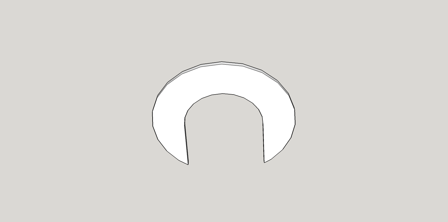

Template for Fine Tuning Quill Extension.png (14.69 KiB) Viewed 6499 times
Sure, John, that would be fair and if it does not come up through the insert you can always enlarge the opening in the insert or move either the carriage or the headstock or extend the quill. That might make it a bit difficult to keep ZCI on hand but that is no big deal either. Just make new ZCI.

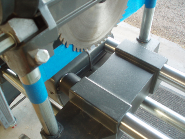

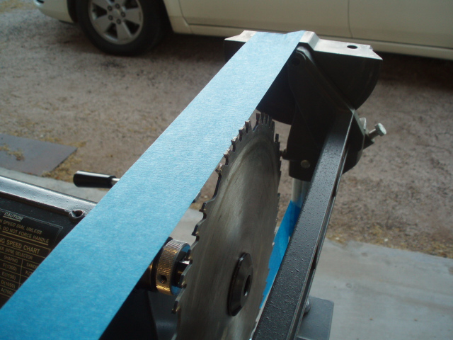

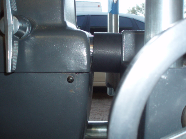

What is depicted in the next two or three photo images is not coincidence. It is what the designer intended.
One image shows how the left face of the blade (right hand face of the saw arbor) aligns with the center line (axis of rotation) of the trunnions.
The second image shows how the plane of the table tubes aligns with the left face of the blade.
This relationship is all established by the design characteristics of the carriage, headstock, trunnion, saw arbor and "rubber baby bumper".

No coincidence here.

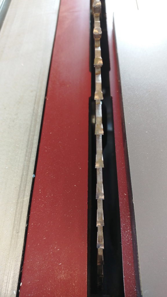

Re: My 520 started singing today.
dusty wrote:What is depicted in the next two or three photo images is not coincidence. It is what the designer intended.

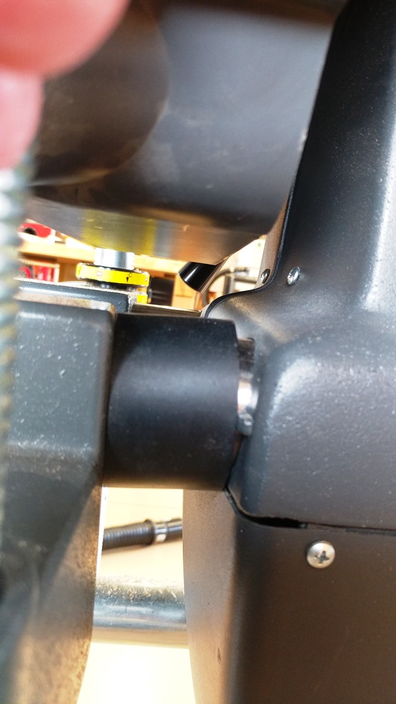

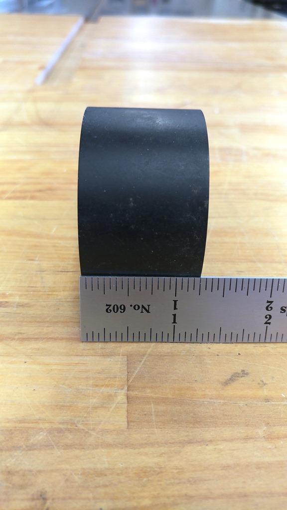

That may be based on your observations. That is if you get a rubber collar of the correct size. Apparently SS has been all over the place with the width. Quality control probably not the design. As you know all parts are made from a print with dimensions. I hope SS is not buying the rubber bumpers from some guy in his basement with rubber hose and a hack saw. Why do they vary in width over the years.
Case in point. I bought my first SS (510) at Woodcraft in Salt Lake City in 1994. At the time I didn't know what the bumper was for since it didn't do anything like space the blade. Three or fours years later I called SS to order something and I mentioned the bumper because I had realized what it was for. They sent me a replacement.
As I remember it fixed the problem but I don't remember if it actually "centered" the blade in the head stock. This is because I replaced the head stock with a new from SS Power Pro head stock in 2013.
So, the original bumper new on my 1994 510 is 1 1/4" wide (first picture). The replacement they sent me somewhere around 1996-97 is 1 1/2" wide (second picture). The third picture shows the same bumper on the same machine with the Power Pro head stock. The blade is clearly not centered in the insert. It is not even close to what I would publish as centered.
So what should I conclude about what the designer intended from this???
dynabase
Posts: 161
Joined: Sun May 26, 2013 1:06 am
Location: Post Falls, Idaho
Post by dynabase »
That last picture (20170601_155006.jpg) is exactly how my blade sits after the trunnion change. Just a little off center. I guess the question that still needs to be answered is where is the blade officially supposed to fit - Center of off center? If "off center" how much is correct?
Michael
