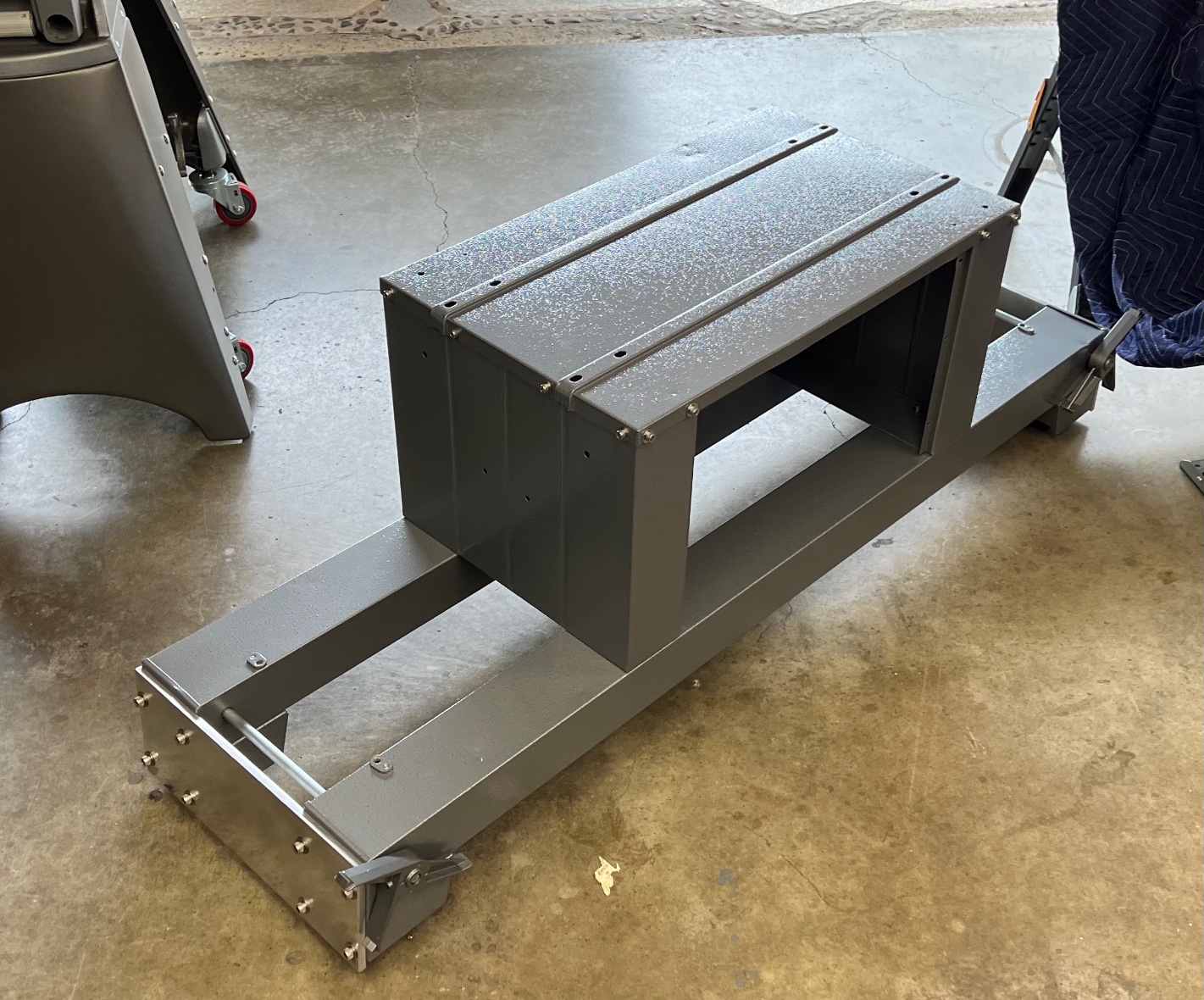

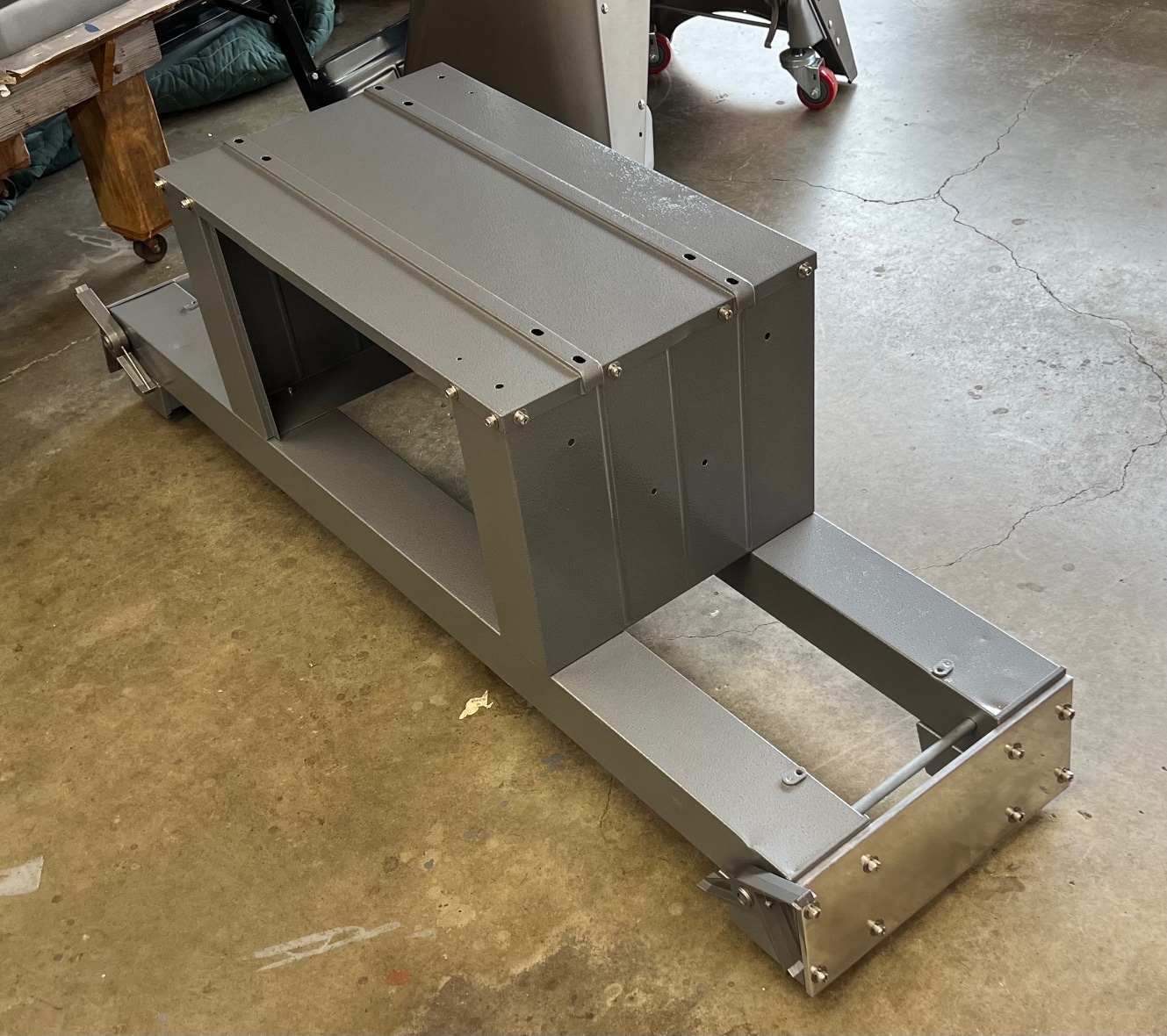

What paint did you end up using on the cabin and headstock? Rust-o-lium? It looks beautiful
1960's vintage Shopsmith Mark VII with Bandsaw, Belt Sander, Jointer
Re: Mark VII a start and a long ways to go..
I think he had it powder coated.
Thanks JPG, yes powder coated gray epoxy with a hammer finish. Other parts will be Rust-oleum gray "Hammered" finish

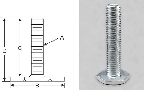

One suggestion - use "elevator bolts" for the 4 vertical stops.
BTW it looks fantastic!!!
Thanks JPGJPG wrote: Sun Oct 23, 2022 12:31 am One suggestion - use "elevator bolts" for the 4 vertical stops.
I believe we are thinking along the same line
HEXL-3Z
Hex Leveling Mounts (Stud Style, Steel, Inch) 5/16-18 with a jam nut and will be going in a flush brass wood insert

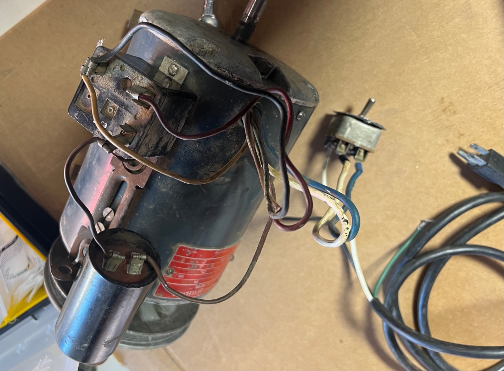

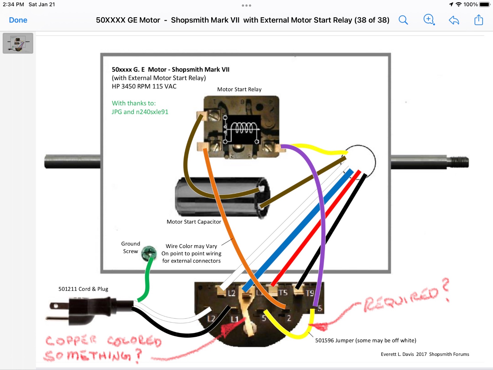

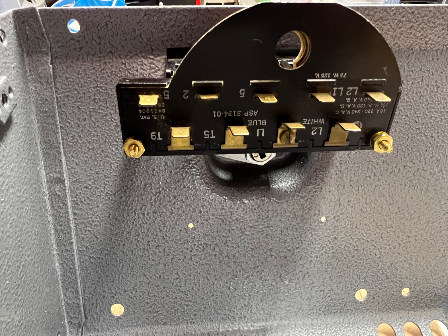

Anyway, starting on the assembly, bearings are all replaced and next on the list is electrical. Once again I want to thank JPG for all the information. Electrical is my greatest weakness when working on old equipment. So here are some pics of what I have and the electrical drawing that I’m pretty sure I should follow. It’s a GE motor with a relay and capacitor. It was rewired for just a switch and I would like to use the original reverse/stop/forward switch.
At present the motor was rebuilt and runs great and I don’t want to screw up the wiring so that it doesn’t do that anymore.
So, if I cut wires, add terminals and hook up per electrical drawing will all function as planned?
I’m guessing I need to add yellow jumper?
I’m not sure what the copper “y” shaped thing is or does that is next to the blue wire? A jumper?
It’s dirty but will be cleaned up before install.
Thank you Miken cam works beautifully!
Thank you for any and all assistance or even any and all critiquing.
Finally getting back into the VII and it will be brief as I have some Covid related procedures that will take me out of commission for most of February. Will be back and running full speed after that.
