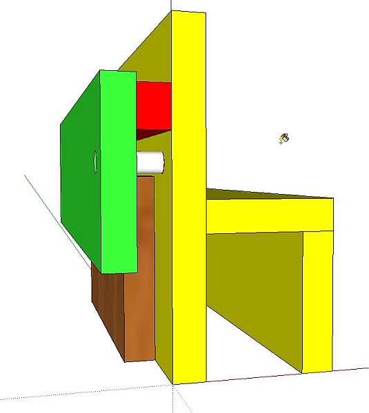

Just a FYI for those who might find the clamping bar a bit to small to clamp what you want to clamp on the jigs of the type sketched below here is a good way to do it.
Also want to mention a piece of psa sandpaper can increase your clamping ability should you find you need it... attach to jig and away you go.
And one more thing which I think I have mentioned before, use a rip blade. Rip blade do a square cut and have no "set" and deep gullets to carry away saw dust. Even a good combo blade my have some set to it and will leave a lot more blade marks.
OK the pieces are color coded. The yellow is the original or new jig you build or have. The wood looking piece is your workpiece. The green is a wider clamping board and the red is a scrap the keeps the clamping square and tight. (Drawing is near scale but not to scale).
[ATTACH]7715[/ATTACH]

How about the white Ed. What kind of fastening is going on there?reible wrote:Just a FYI for those who might find the clamping bar a bit to small to clamp......
