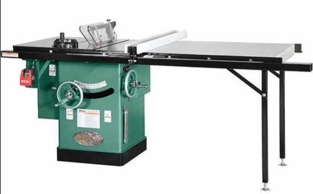

OK, I WILL ask the question.
Let's take a saw like the Grizzly G1000 series table saw.
grizzly cabinet saw.jpg (87.96 KiB) Viewed 1180 times
To my eye, which I admit is still noob, looks similar to a 520 ProFence system on a Mark V or 7. This unit has less rip capacity but more HP and costs 1500 dollars or so......
Would this "table" live up to one thousandth tolerance like is expected on our machines (I understand you can "align" the extension tables and achieve that, but when swapping them you find they are "off".
Would the grizzly be held to that much of a standard?
Secondly, it this kind of tolerance necessary for woodworking? I work with less tolerance when building a 350 horsepower small block chevy or Ford engine.
I am just amazed that we are even talking these kinds of measurements. Are they necessary?
Trust me, I am not arguing, I am just having to rethink my approach to making wood projects if this kind of tolerance is needed or desirable ..... :confused:
Dick
1965 Mark VII S/N 407684
1950 10 ER S/N ER 39671
1951 jigsaw X 2
1951 !0 ER #3 in rebuild
Re: Truing, As Best You Can, Shopsmith Table Tops
Unless you intend to move the table extension to the left side, there is no similarity the the left right aux table issue on the SS.
I assume the only thing adjustable is the leg height. Maybe at the other end to match the height of the two tables.
I think the procedure would be similar - straight edge etc..
I think we take alignment too far in these discussions. Getting it as good as possible is a personality trait. The only reason for going the extra mile is that it insures better safety and accuracy and less grumbling when things do not happen as they should because of some picky alignment detail.
