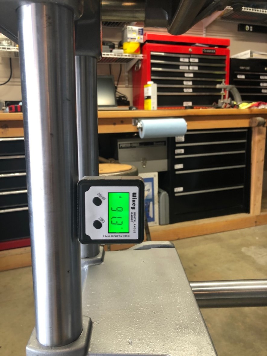

Wixey showing rotation through 90 degrees to 91.3 degrees (1.3 degrees rotated past 90 degrees)
Mike 4.jpg (139.92 KiB) Viewed 1044 times

The wixey says the wixey has been rotated 91.3 degrees.
The 90 degree point(tube vertical) would indicate 90.0egrees.
The wixey rotated CW 1.3 degrees past that.
WHY?
Because the tube is not quite vertical(UNDER rotated).
I think our earlier discussions re over rotation has been baloney.

JPG wrote: Sun Sep 12, 2021 8:09 pm The wixey says the wixey has been rotated 91.3 degrees.
WHY?
over
That makes no sense to me. If it was under rotated wouldn't the Wixey read less than 90?

algale wrote: Sun Sep 12, 2021 8:28 pm
No, you have to go back to the earlier photo where this one came from, and see the previous photo that showed it at zero. There was a mistake in how the Wixey was placed. In the previous photo it was attached to the top of the bench tube, and then rather than rotating the Wixey counter-clockwise, where it would be on the left side of the way tube, it was rotated clockwise and attached to the right side of the way tube. So it’s upside down and showing over rotation rather than the correct under rotation. That was where a major confusion was introduced into the discussion.

Oh, and I think that photo ended up sideways too? Making the confusion even more confusing.
WHY?
over
This post is relative to the two pix posted by Dusty.
The 91.3° pix shows the wixey rotated CW 91.3° from level(horizontal).
The wixey is over 90 rotated to attach to the way tube which is 'under' rotated by 1.3°.
Majones1

Mike wrote: Tue Sep 07, 2021 12:58 pm Ed- it’s bottomed out and still leans towards operator-
Here are a couple pics with zero on bench tubes
These are the two photos that I was talking about. If you look closely you will see the second photo is actually sideways, and I believe this is the photo that Dusty re-posted above, after correcting the rotation. Also, in that second photo, you can see that the Wixey was rotated incorrectly from zero, further confusing the issue.
Or am I seeing something wrong?
Marc Jones

Re: Shorty Drill Press not perpendicular to floor, any ideas?
Majones1 wrote: Sun Sep 12, 2021 10:13 pm
Those pix are the original.
Current 'discussion' is re DLB's pix.
Regardless both sets of pix show the action of the wixey. Understanding that is the obstacle to complete understanding of just what IS being demonstrated by a pix of a wixey attached to a way tube.
