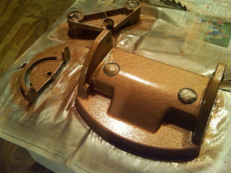

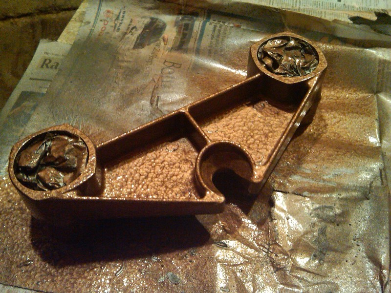

After lots of Citrus Strip, brass brushes and toothpaste (thanks JPG - works great), I've started testing this Rustoleum Hammered Copper on a few pieces. I primed first with Self Etching primer after cleaning up the components with mineral spirits. The pinholes in this first coat of paint show the tint of the primer.
[ATTACH]11095[/ATTACH]
I'm not too concerned about a consistent coat. I observed quite a bit of variation in the factory finish, which I didn't notice until I began focusing on paint removal.
[ATTACH]11096[/ATTACH]
[ATTACH]11097[/ATTACH]
The base really isn't this bright but the flash went off in this shot, giving it a brighter appearance.
[ATTACH]11098[/ATTACH]
[ATTACH]11099[/ATTACH]
This is some crazy paint and I really don't like painting on vertical surfaces with it. The layer has to be almost runny for it to pit and make the hammered surface. At least with normal paint the desired look can be achieved with multiple thin layers. I'm not so confident thin layers are the way to go with this but we will see. I have a heavy trigger finger, so to speak, so I got some runs on one side of the base. I'll probably sand that down and repaint with it standing on end. I'm interested to see how the second coat goes on.
I still have a good bit of body work and paint removal on other components but I've been itching to see how this paint would look. I may experiment with wet sanding the primer and compare that to no primer at all to see what kind of adhesion I get. I noticed mickyd had some issues getting his Verde Green to pit as it should when applying on primer but I didn't notice much of a problem with the Hammered Copper.

Light coats do not get the hammered look!
The can MUST be shaked often(the paint is a 'mixture' that creates the hammered effect).
Yes vertical surfaces are prone to running since a fairly heavy coat is required for the 'effect'.
Does require some 'technique', but you seem to have mastered it.
You can 'spot' reapply after 24 hrs. The can says soon after initial coat, but that tends to get runny.
The 'effect' develops on horizontal surfaces better than vertical surfaces. You can rotate the part and paint a different surface if ya wait 10-15 minutes after initial painting(it sets enough to not run). This is a way to work around 'vertical' surfaces.
Not too shabby for an initial attempt. Actually the 'heavy handed' application helped!
P.S. Notice those surfaces not originally painted and mask them off.(trunion scale/clamp area).

Thanks for the tips, JPG. I just followed the directions on the can that say to overlap passes. It also talks about using a specific rust prevention primer but all I had was self etching primer. Besides, the parts I painted are aluminum.JPG40504 wrote:Light coats do not get the hammered look!
The can MUST be shaken often(the paint is a 'mixture' that creates the hammered effect).
