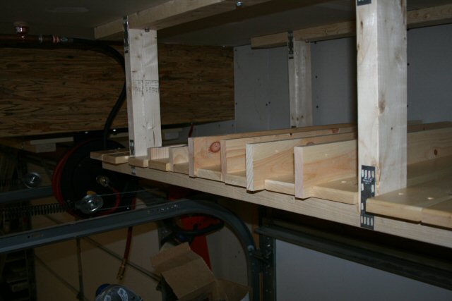

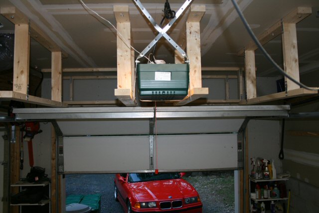

About 3/4 of the way done:
[ATTACH]2000[/ATTACH]
There's 2" of clearance on either side of the garage door opener, which will allow me to upgrade to a somewhat larger model in the future if needed.
Things went swimmingly well until I tested the clearance between the garage door and the shelving. I disconnected the garage door opener and raised the door manually. The shelves at the front of the garage have a good 1.5" clearance. But for the ones by the garage door opener... oops:
[ATTACH]2001[/ATTACH]
I intended to have about 3/4" clearance between the shelving and the garage door at its highest point, but somewhere that got lost in my cuts, my wavy ceiling, and the variation between the garage doors. I used a belt sander to taper the leading edge of the shelving supports so the garage door can't catch the edge and do serious damage, but there might be some slight rubbing. I think I can do some tweaking in the roller channels to move the door down a bit. Hopefully I can get to a point I'm comfortable with which won't require remaking half these supports.

I switched to drilling out the pilot holes with a bit sized exactly to the inner diameter of the threaded shaft. I learned that if you drill a pilot hole and you smell sap, or if the drill bit works to drill the hole, it's best to clean the hole out real good and use a bit more lube on the lag bolts.
Speaking of lag bolts, I have a new favorite lube - liquid car wax! It spreads onto the threads easily and really makes the lag bolt thread in nicely. I tried liquid car wash soap and bar soap, and this is by far my favorite. Plus, I think once the water content of the wax is absorbed by the wood, the wax will remain behind in case the bolt must be removed for any reason.

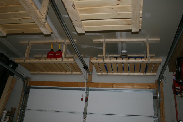

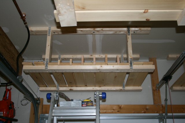

Almost there... I have all the slats screwed on the front shelves in with sheetrock screws:
[ATTACH]2065[/ATTACH]
I haven't put a whole bunch of stuff on them yet, as I need to spend some time thinking what qualifies as "occasional use" stuff where I don't mind pulling a car out of the garage and shutting the door to get to it.

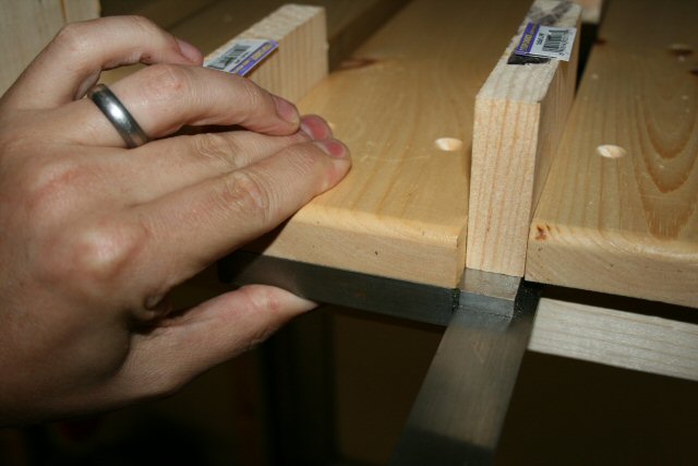

The slats were designed to overhang by exactly 1". The thickness of my engineer's square was 1", so I just held that up and pulled the slat out to the proper overhang:
[ATTACH]2068[/ATTACH]

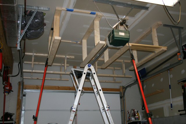

I had a carpenter/contractor friend of mine over last week to do some other work on the house. At the time, the slats weren't laid out on the ceiling supports and the supports were just bare. When he was in the garage, I pointed up at them and said, "How much weight do you think those would be rated to hold? I glued and screwed them, and put those mending strips along the sides." He asks me, "are the lags all attached and finished?" and I said yes. He JUMPS up and grabs onto the one over his head, and proceeds to swing from it!
Now imagine a guy 6' 4" and 285lbs, a dead ringer for Paul Bunyan right down to the beard. He hops down after a few swings and says, "Well now you know they're rated for 285 pounds!"
I about had a heart attack... There was some lateral play when he was swinging (he was swaying more than swinging) but now that all the slats are attached and I snugged up the lag bolts into the ceiling, the shelving units are absolutely rock solid. The slats pull themselves flat against the 2x4s, helping to keep everything square.

If you want, you can stop lateral swinging by installing a couple of small gussets. Just make some small wood triangles and affix them to the vertical pieces and the slats. They don't have to be large, just -2" on the legs of the triangles. (2,2, and sq root of 8):rolleyes: You can make them from the scrap of slats. Should give practice in cutting miters?:D
