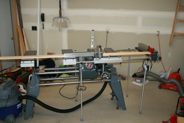

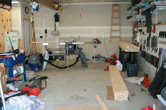

The first picture shows my messy garage, and the Shopsmith rolled away from the back wall and prepared for duty. I don't have much space to work with, and I have to keep one of the vehicles out of the garage for the duration of the project. This is why I like the Shopsmith - when not in use, it takes very little space for the capabilities it provides.
[ATTACH]1273[/ATTACH]
Already, I learned my first lesson - make SURE the casters are raised and the Shopsmith is sitting firmly on the floor before setting up all your extension tube support legs! After setting up all the legs, I bumped the table and the Shopsmith rolled and I realized my error. I couldn't just raise the casters because then the whole unit would drop and the legs would be a bit too long, bending the extension tubes upwards. I loosened all the support legs, raised the casters, and then firmed up the legs. I took a 1x4 and laid it across the table sitting vertically to act as a straightedge. It was trickier than I thought to adjust the auxiliary table height and all the support legs to get everything just right, front and back.
You can also see my dust collection system. On the left is my Shopvac with a 2.5" hose. I have it hooked up and I'm testing its dust collection capabilities. On the right is an inexpensive $90 Harbor Freight mini dust collector that I borrowed from a friend. He uses it for his sandblasting cabinet. It has a 4" primary hose with a 2.5" adapter on the end. I will be trying that too.
I don't have any electrical capacity left in the garage to run dust collection at the moment. There is one 20A breaker which feeds the entire garage, including the 320W of fluorescent lighting (four fixtures, each with two 40W bulbs). Fortunately, the Shopvac's cord is long enough to reach an outlet down in the basement (my house is a split-level, so it's half a level down from the garage).

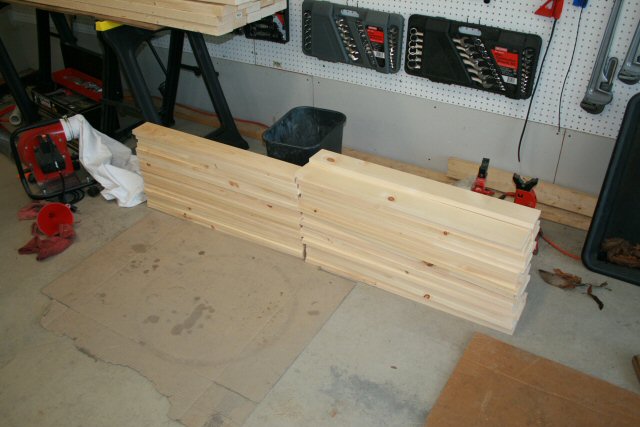

Here is the pile of exact-length pieces (2/3 of the slats done!):
[ATTACH]1275[/ATTACH]

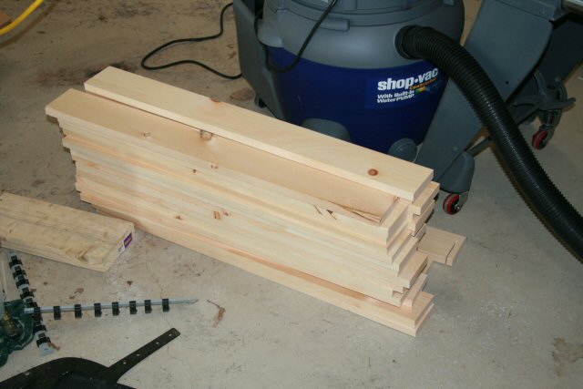

Here is the pile of pieces I need to trim (1/3 of the slats):
[ATTACH]1276[/ATTACH]
You can see the one piece on the floor in the rear of the pile where I accidentally slid the piece all the way against the rip fence instead of the featherboard. I realized this once I heard the blade sounding different. I think it was binding up against the fence.

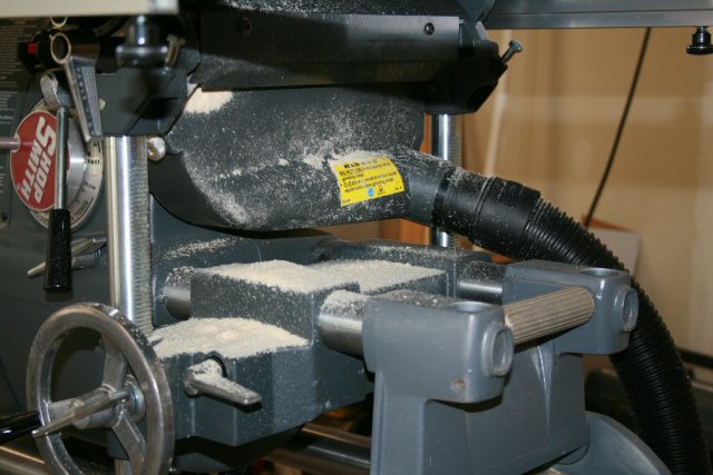

Here is the sawdust which settled on the main table carriage after I was done:
[ATTACH]1277[/ATTACH]
Is this an indicator that the Shopvac has insufficient capacity for dust collection? Or is this normal and unavoidable when cutting? If I use a big honkin' dust collector like the big boys do, will this be completely eliminated or simply reduced by a large amount?

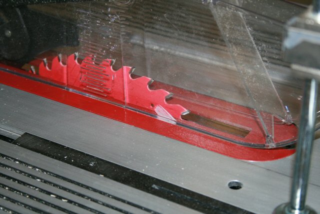

As I cut each piece, I would pull the workpiece away from the blade on the left-hand side, then walk a couple steps to the right (moving clear of the blade) and pull the cut-to-length piece straight to the right away from the blade. While pulling one of the pieces away from the blade, I guess I pulled it away too quickly. The upper guard was sitting on the workpiece and it pulled the guard into the running blade:
[ATTACH]1278[/ATTACH]
When I checked the guard, I noticed there is a fair amount of side-to-side play in the upper guard itself even though the knob is tightly clamping the riving knife to its mount. It is something else to be aware of. I'm not sure if this much side-to-side play is normal. The play seems to be in all the pivot points in the upper guard arm and pivot points. Perhaps I can find a way to add some extra washers to remove some of this play.

Chris,
When I look at your pictures I see one beautiful shop in the making. It's looking good.

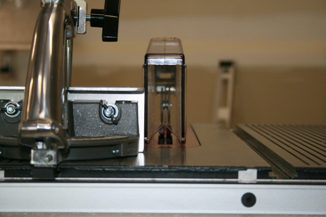

I need to ask something though. In the second photo (IMG-1701), do I see that you are using the rip fence as a gauge in conjunction with the miter gauge. I see the red featherboard - is the the stop that you are using for length? Just don't let the "cutoff" get caught betweem the blade and the rip fence.
Your question about the dust collector. You ask if the dust around the saw blade is an indication that the Shopvac does not have enough capacity to function as dust collection for your Shopsmith. I have to so NO it does not because I have the same on my Shopsmith using the DC3300.
I believe this is a visual indication that the lower saw guard does not function well in its' capacity within the dust collection system. There is too much leakage in and around the lower saw guard. I have moved the lower saw guard in tight against the blade, opened it as far as it will go and all points in between. I still have an unusual collection of dust. The only real variables are two. Is there anything else connected to the dust collector and what kind of saw dust am I making.
You only have one port so it can't be that. When you empty the dust collector, you'll know how much dust you are collecting.
Now I am not saying that the Shopvac is as good as any other dust collector you might use. But I am saying that the Shopsmith DC does not get 100% of the dust - maybe not even 80% of the dust. I just don't know how to quantify it.
I do know that if I spend any time without the dust collector, I will spend a lot longer at cleanup.
ps -- I see your ear protection. Do you use eye protection as well?

I notice in your photo that the lower guard is not extended out all the way to the tie-bar guard (or whatever it's called). You might get a little bit better dust collection if you closed up that gap. You'll never get it all, however. That's why everyone should wear a dust mask.Is this an indicator that the Shopvac has insufficient capacity for dust collection? Or is this normal and unavoidable when cutting? If I use a big honkin' dust collector like the big boys do, will this be completely eliminated or simply reduced by a large amount?

dusty, you are correct about the featherboard. I am using it as a stop so that the workpiece is not in direct contact with the fence once it meets the blade. There is about 1" of forward travel as the 1x4 leaves the stop before it meets the blade.

Bruce, you have keen eyes - great catch on the lower guard! I just assumed closer to the blade was better, but I never even noticed the gap that you described. I went back down and pulled the outer lower guard back out until the gap was closed. Hopefully this will help a bit!

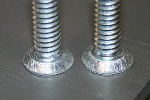

4. One thing I noticed when attaching the 24" aluminum extension to the miter gauge face was that when I would tighten down on the wingnuts, the countersunk bolt heads would simply spin instead of catching so that the wingnuts would tighten on the bolt.
First, I took some coarse sandpaper and put some radial scratch marks on the extension bolt heads:
[ATTACH]1280[/ATTACH]
I also put similar scratches on the matching countersunk surfaces on the extension face. This worked very well, but the bolt still began to turn as the split lock washer was mostly flattened. Once I removed the lock washer, I was able to tighten and untighten the wingnuts completely by hand without the bolt slipping.
I'm going to run without the lock washers and see if they're really needed. I might be able to get by without them. I'll toss them into my "miscellaneous bolt/nut/screw" bucket, never to be seen again...
Random note - one of the limitations of using the rip fence on an extension table, whether it's as a rip fence for plywood or as a stop, it is no longer guaranteed to be square. It depends on how square the floating table is when you snug it down on the tubes. With my setup this was okay because I ensured the featherboard/stop was moved forward so that the workpiece has moved past the stop as it meets the blade. The fence stop assembly didn't need to be square to the blade, it just needed to serve its purpose as a stop. But, it's something I hadn't considered until I ran into this binding.
- Chris
Only other comment I have is with regard to the binding you describe. You are correct that it could be a result of the fence being out of parallel with the blade when mounted on a floating table...But...the reason it is never a good idea to use the fence by itself as a stop when cross-cutting is that even if the fence is perfectly parallel to the blade, once the kerf in the workpiece is created there is the potential (read "extremely high likelihood") that the work piece will creep a bit, closing on the kerf and moving itself askew of the line of cut. This means that the workpiece will, along the diagonal, become longer than the distance between blade and fence, resulting in, if you are lucky, a binding sensation and an odd sound but if you are not so lucky a scary kickback. And remember, this can happen even if the fence and blade are perfectly aligned. Bottom line, maybe the fence was too blame, but please consider the possibility that it wasn't.
