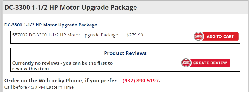

I hope that the answer Paul go is the correct answer and the answer I got was incorrect. The problem, perhaps, is that Paul asked: "I am looking at purchasing the dc6000 upgrade. Will it make my old dc3300 the same as the new dc6000?" The upgrade is not called a DC-6000 upgrade, it is 557092 DC-3300 1-1/2 HP Motor Upgrade Package. So did they (specifically Denise) understand what he was asking? The answer specifically states it was to the CFM question, but just as Dusty asked, is that the DC-3300 upgrade, DC-6000, or both?
All of this due to there being neither picture nor product description to be found...
If I had received the answer Paul received I would have bought it and then looked at the content when it arrived. I don't believe that SS would do what it sounds like they are doing. I still think we have bad info, stemming from the absence of a description. Would they really provide a 300% increase in power with no way to consume that power? That would indeed by slimey. That's inconsistent with my experience, incorrect info from CS is not.

DLB wrote: Mon Jun 28, 2021 10:56 am I spoke to SS CS this morning and she indicated that according to the BOM there is no impeller or fan in the "557092 DC-3300 1-1/2 HP Motor Upgrade Package." There is a motor, connector, motor housing, seals, screws etc. There was no fan or blower housing. I don't understand the overall picture here, but I'm not ready to pay for a call to SS engineering to get product description information that should already be in the on-line catalog. As far as I know there is no power issue running the existing impeller on a 1/2 HP motor, I've never heard it slow down. If the "package" came with an impeller I would have bought it to evaluate and report the rest of the story here. But I've got nothing to go on that makes me want this at this time. Perhaps when a product description is added that will change.
Note - I've never been terribly disappointed with a SS upgrade and I've bought several. I can't imagine that this actually is as it currently seems to be. I'm thinking that $280 should buy a significant performance upgrade. I presume I'm still missing some important piece of info.
- David
I would not disagree BUT if you check the price for a DC3300 motor only the Shopsmith price is $321.64 (515590). Historically, Shopsmith has priced their motors on the high side and they can because most of them are unique to Shopsmith. I might buy the upgrade kit just to get a replacement motor.
