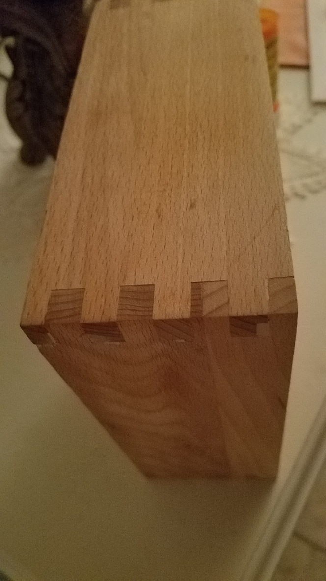

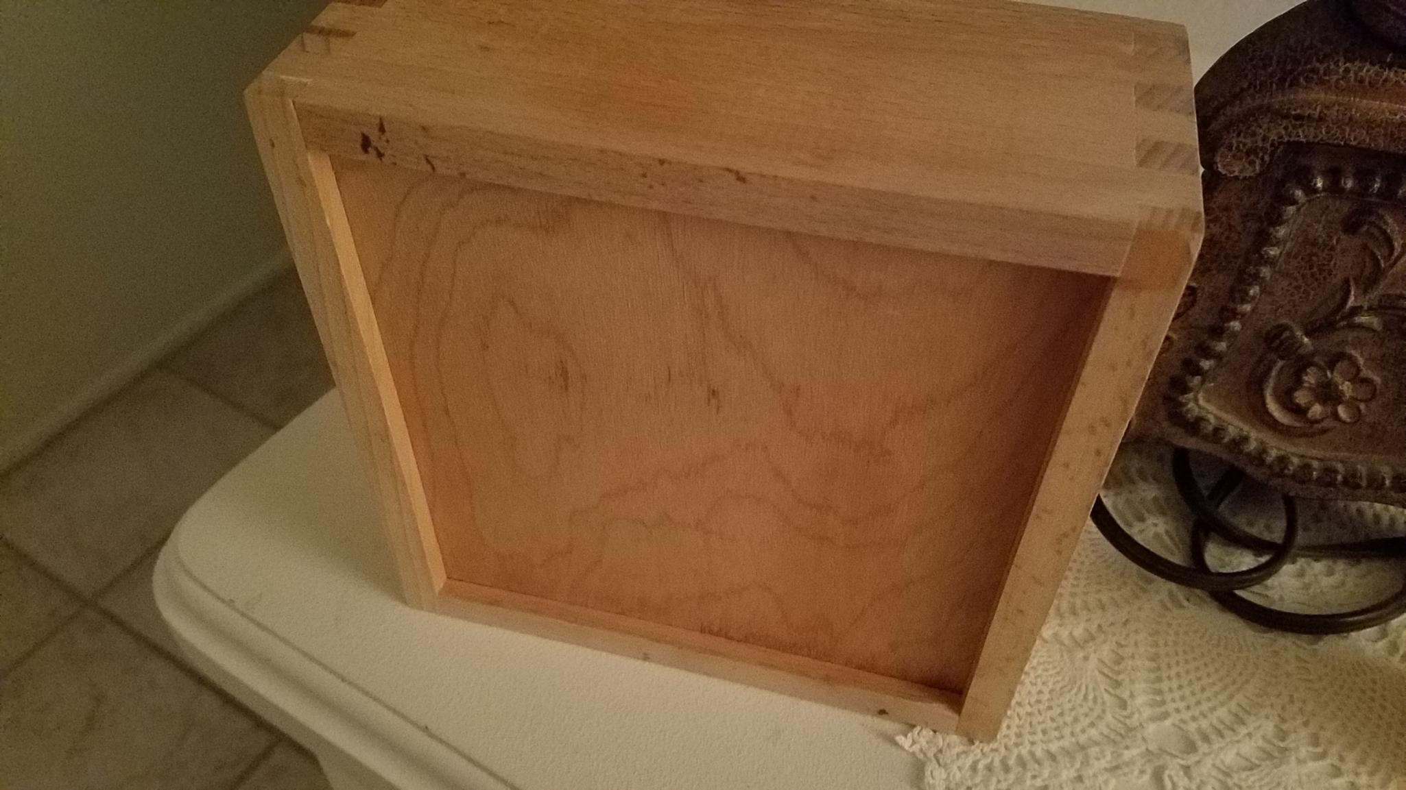

Not perfect but functional. This was preceded by several practice cuts that did not make the grade. Yes, I did use some wood filler. Had some unexpected chipout.

Nothing wrong with those! Looks good.

Half of the pins are shorter than the other half. Obviously, two of the side pieces were of different thickness.
Obviously the stock thickness should be very close but a lot of videos I have watched say cut the pins slightly long and then sand them flush. I think even the I-Box instructions mention that.
That is what I did and it works very well. You can see the results here.

I used the SS disk sander with the fence as a backup and used the quill feed to get very close. Then I finished with a ROS with 320 grit SS ceramic paper.
Those joints loop pretty good to me.

Thanks, John. But in the quest for that perfect joint I should have done what you suggest. Cut them long and trim them to match.. I did not do that right even though that was my intention.
Sure glad this wasn't being done as a gift for someone. It just holds my pill bottles. Should have made it a bit bigger.

That is why in my opinion it is important to make a test joint with the same material as the finished product. That way you can do the tweaking then and know when you make the real cuts they will be "perfect ;) "
Early in my learning process I made a box out of 1/2" Baltic Birch. It looks to be about the same size as the one you just made. I dry fitted it and showed it to my wife and said that I needed to sand the pins flush. She said she liked it the way it is so I glued it up and gave it to her. That is what she keeps her pill bottles in.
