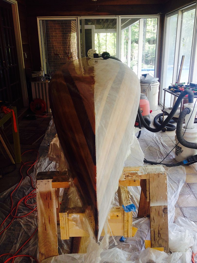

More sanding! When I left off last fall, I had put three coats of epoxy on the outside of the canoe but while it looked ok in the pictures there were a lot of drips and runs. Yesterday I spent several hours sanding one half the outside of the hull perfectly smooth.
Half Sanded
Half Sanded
Unfortunately, there were some areas where the epoxy was too thin and I got some of the fiberglass pattern lightly showing through in spots. So I believe I will need to add one more skim coat of epoxy and lightly re-sand before I can varnish the outside of the hull.
Considering that preparing the inside of the hull is, by all accounts, the worst part of the job, I am not looking forward to it. When you look into building a canoe, the books tell you there's a lot of sanding involved. But nothing prepares you for doing it. It is mind and finger numbing work.

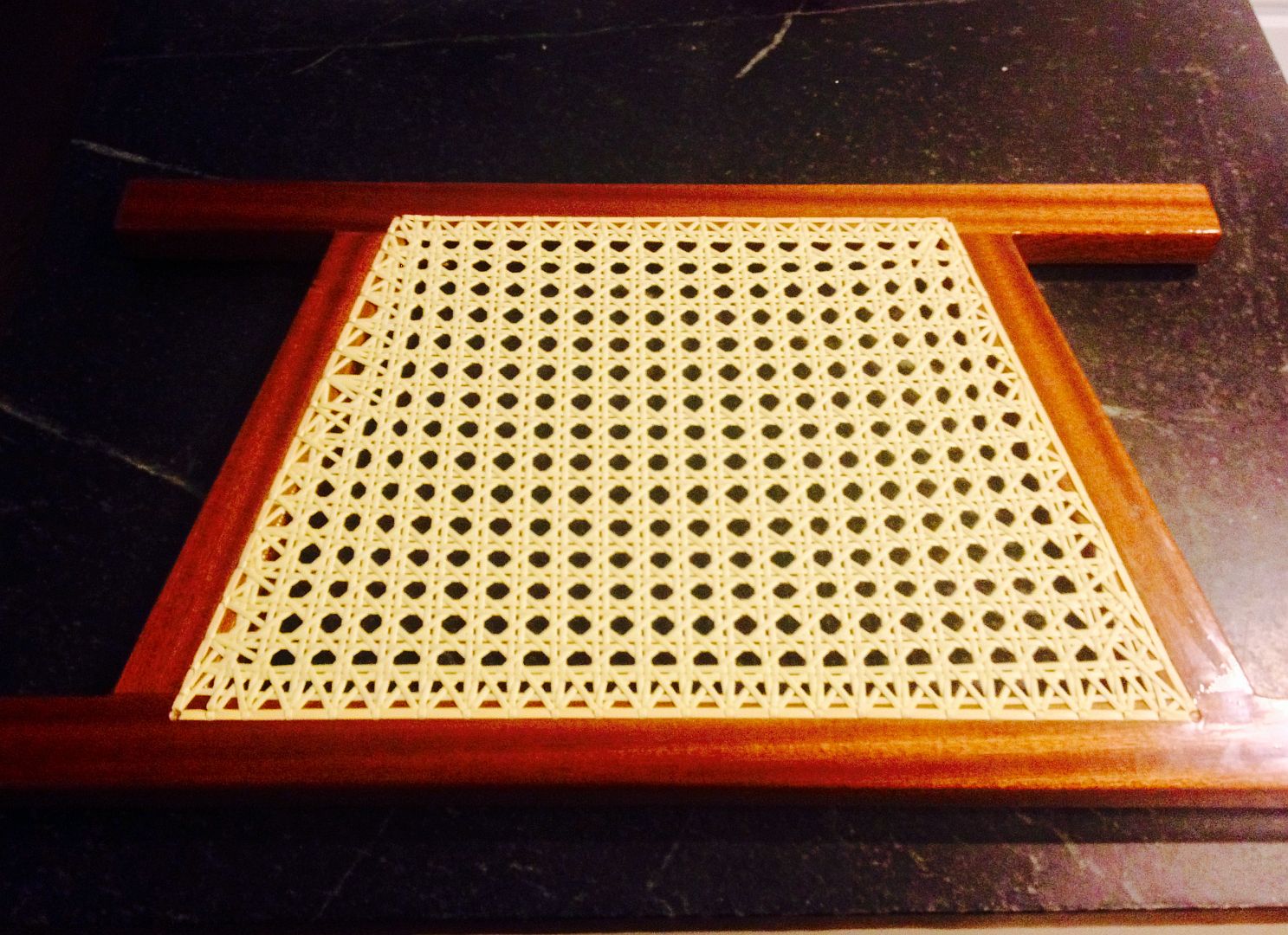

First time caning. Supports my weight so it is a success!

Re: A Slow Boat To Nowhere
Posted: Sun May 10, 2015 12:48 pm
by charlese
Algale - That caning job is simply real, real Cool! Ain't it fun to try new/different skills?
You do very good work, my friend! :D
Excellent Job! at a new found skill! :D

Thanks, Charlese! Your work is inspiring, so any compliment from you means a lot. This canoe build has been an exercise in acquiring/learning new skills (slowly). And it has been a blast.

by shipwright
Looks great Al. Looks like you wove it in place right? I've done it with manufactured sheet and reed splines but your edges look hand woven..... Well done!
