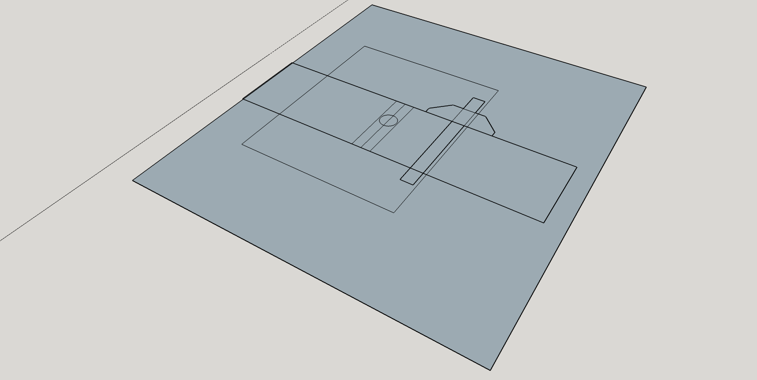

It might not (probably is not) a good idea to mount the I-Box on the Shopsmith Router Table.
I did a rough sketch of the miter bar, router table and I-Box to show the relationships. Remember, I will need to cut a miter slot for the I-Box Miter Gauge. It can not be located where drawn. I would have to move it away from the cutter which I fear would be approaching the end of the I-Box so far as to lose stability.
I located the miter bar at the same location on the I-Box as it is for table saw operation (as a starting point).

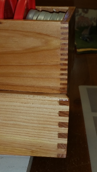

Re: I BOX review of sorts (spoiler alert)

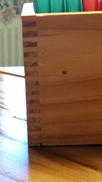

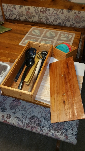

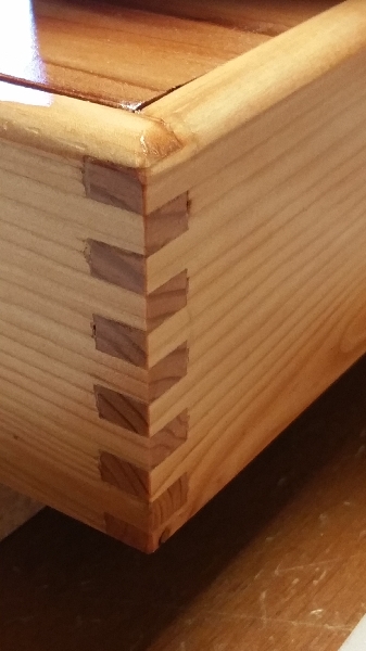

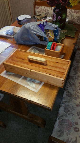

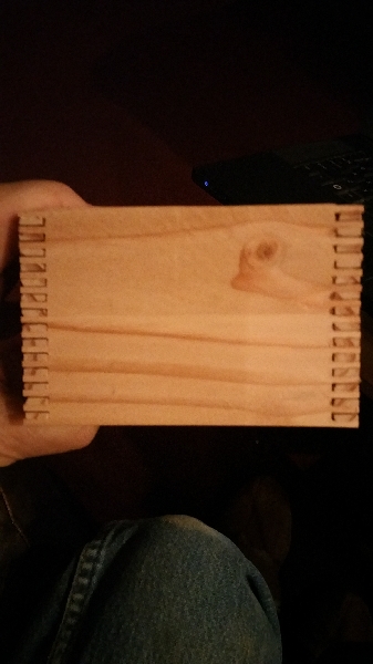

As promised, here are the pictures. There is some tear out which is part on me, part on the blade(s), and part on the wood (fir) so I don't blame the Ibox for that. All in all, pretty good for me ....
It sure does make it easy ....
Raw, unsanded right out of the ibox jig 1/8 inch Sanded and finished finished 3/8 Compairison of the two Full box pics ...

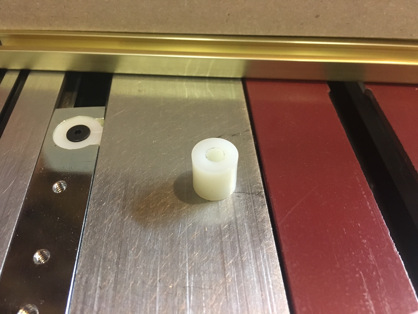

Just went to set up my new iBox and this fell out of the fence. Anyone recognize it or where it goes?
algale
There was one in my box to. Never have figured out where it goes. It's in my junk box.
Interesting. I called customer service and they promised to get back to me. Obviously they are stumped.dgreen810 wrote:algale
