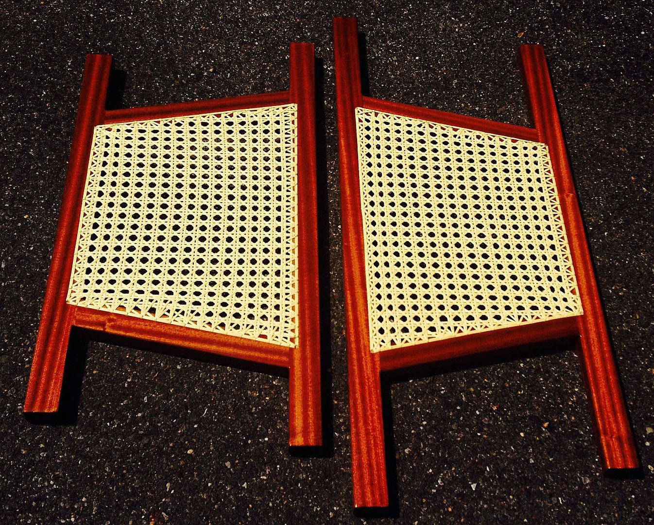

The seats are done until installation. The stern seat (left) and bow seat (right) taper in opposite directions to better follow the lines of the canoe. The sitting portion of the seats is the same on both seats but the wings/legs are different because the stern seat is installed further back and in a narrower part of the canoe than the bow seat.
Canoe Seats Done.jpg (493.42 KiB) Viewed 6934 times
Both will have their wings/legs trimmed down to exact size once the interior of the canoe is done.
Caning isn't hard but takes patience. On the bow seat one of the left/right (up/down in the photo) strands broke after I had weaved the diagonals, but I was able to weave in a replacement strand without too much difficulty.
I am very pleased with the results, imperfections and all.
