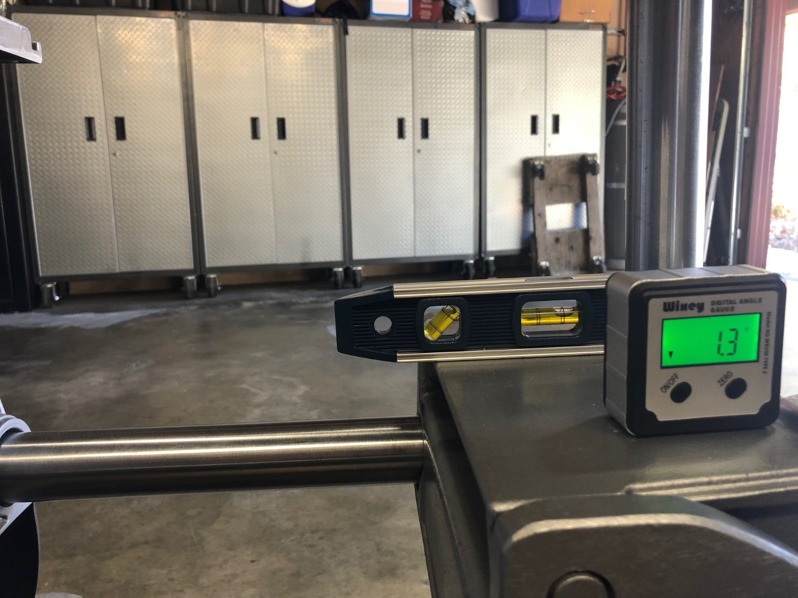

What also escaped me the first few times I studied this pair of images was that the Wixey was zeroed on the Bench Tube and then moved to the Way Tube without acknowledging that there is a 1.1 or 1.2 degree delta introduced by the Base Arm. This is displayed two or three times in other sets of photos.
A previous image shows  the Wixey zeroed on the Bench Tube
Mike xx.jpg (239.97 KiB) Viewed 1597 times
PS: 9/18/2021 The Wixey is resting on the casting and if you visually examine that casting you will readily see that that surface will not be level with the tubes. It should not be used during this alignment/test.

That 1.3° has nothing todo with way tube rotation(unless thee assumes that surface is perpendicular to the tube.

JPG wrote: Wed Sep 15, 2021 4:06 pm That 1.3° has nothing todo with way tube rotation(unless thee assumes that surface is perpendicular to the tube.
On two samples I measured that surface at about 0.8 degrees the other direction. With Wixey zeroed on the Bench tube. Neither parallel with the base tubes nor perpendicular with the way tubes. It was a useful data point, I thought, because it narrowed the possibilities of what could be wrong/different on the OP's machine. Used in conjunction with his measurements on the base casting flats, it points conclusively (IMO) to an abnormal Base Assembly. Neither of those surfaces are precision surfaces, but they provide information.
