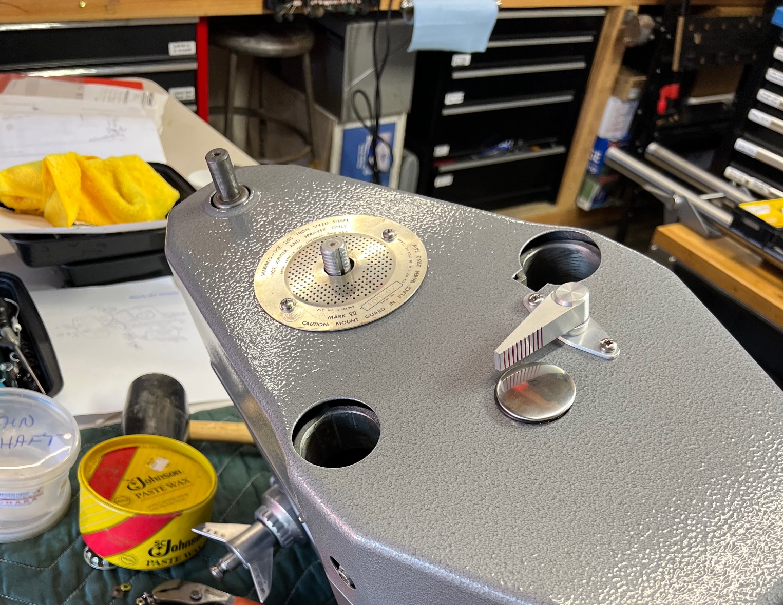

JPG-I don't know what to say but you got it all going on as far as this Mark VII. Ran it up and down, it all works, but did not check speed. I'm still a little gun shy with just the headstock running on my bench. Gonna get back at it. Thanks you!!

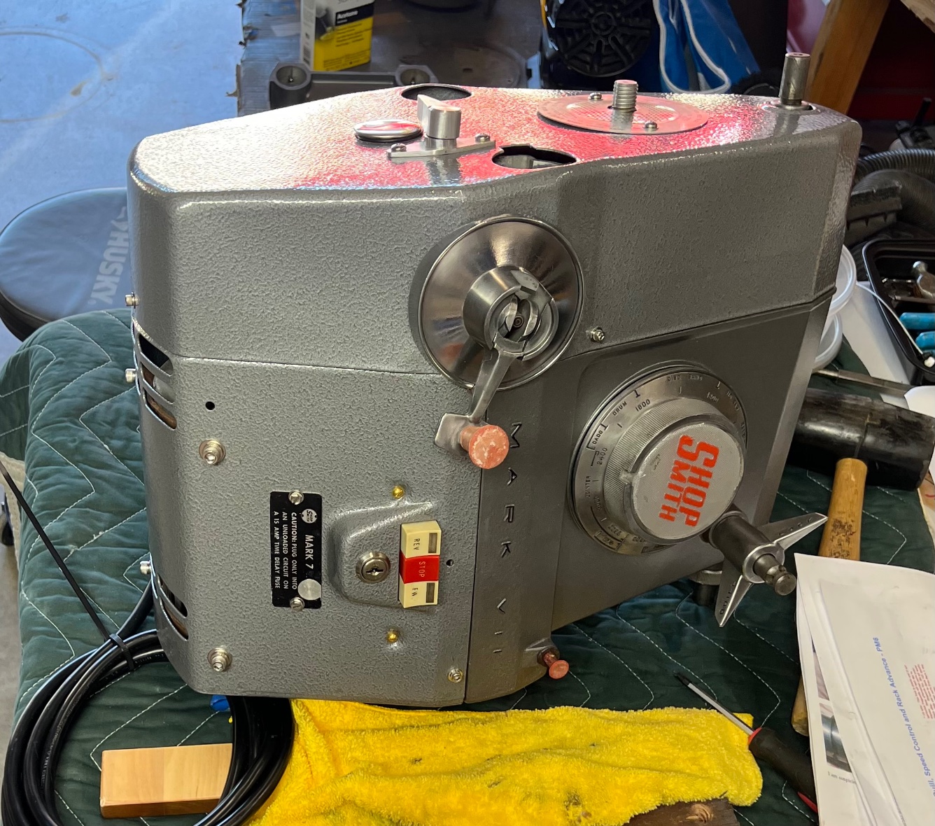

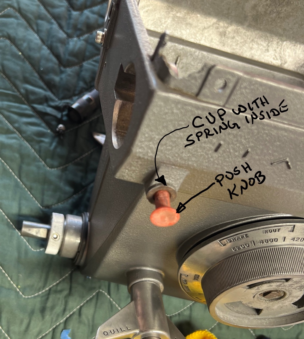

Couple pics, one on completed headstock the other a different configuration for the carriage lock push button. Spring is different just an fyi
- IMG_2517.jpeg (699.68 KiB) Viewed 2797 times
- IMG_2516.jpeg (619.38 KiB) Viewed 2797 times
- IMG_2507.jpeg (406.82 KiB) Viewed 2797 times

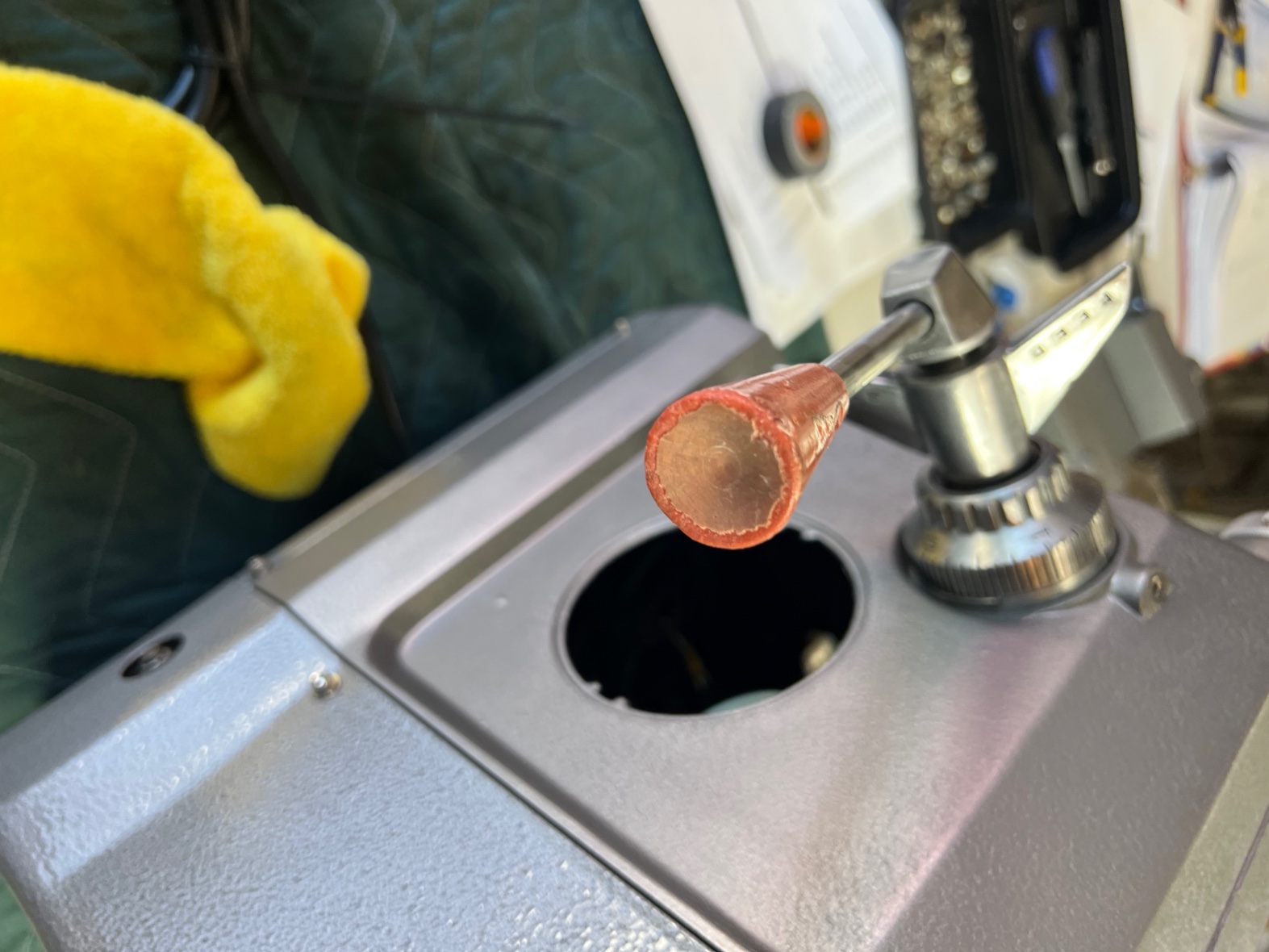

"Try" treating those sick looking red plastic parts with JPW. No guarantee here.
The rest looks OHHHH SOOOO GOOOOD!

Try using a heat gun or hair drier on the plastic to see if it will help with restoring the color. Start with a little heat a distance away and gradually increase the heat but not to the point it starts to bubble or melt. Stadiums use heat to restore the color of the plastic seats and I have seen other people use it to help restore the color to other plastic items.

Lol, yeah the buttons are some kind of ugly, I’ve tried to polish with headlight cleaner, wd40, buffing compounds. will try the JPW and heat gun might be the ticket as well. I used something else on an earlier rehab that worked great but I don’t remember what it was.

Another ugly plastic part, they appear to be decomposing a bit. JPW not any help. Have a heat gun and will give it a shot, worse case I know a guy.

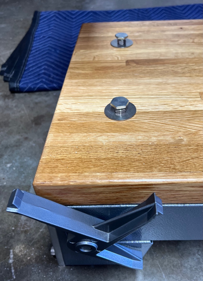

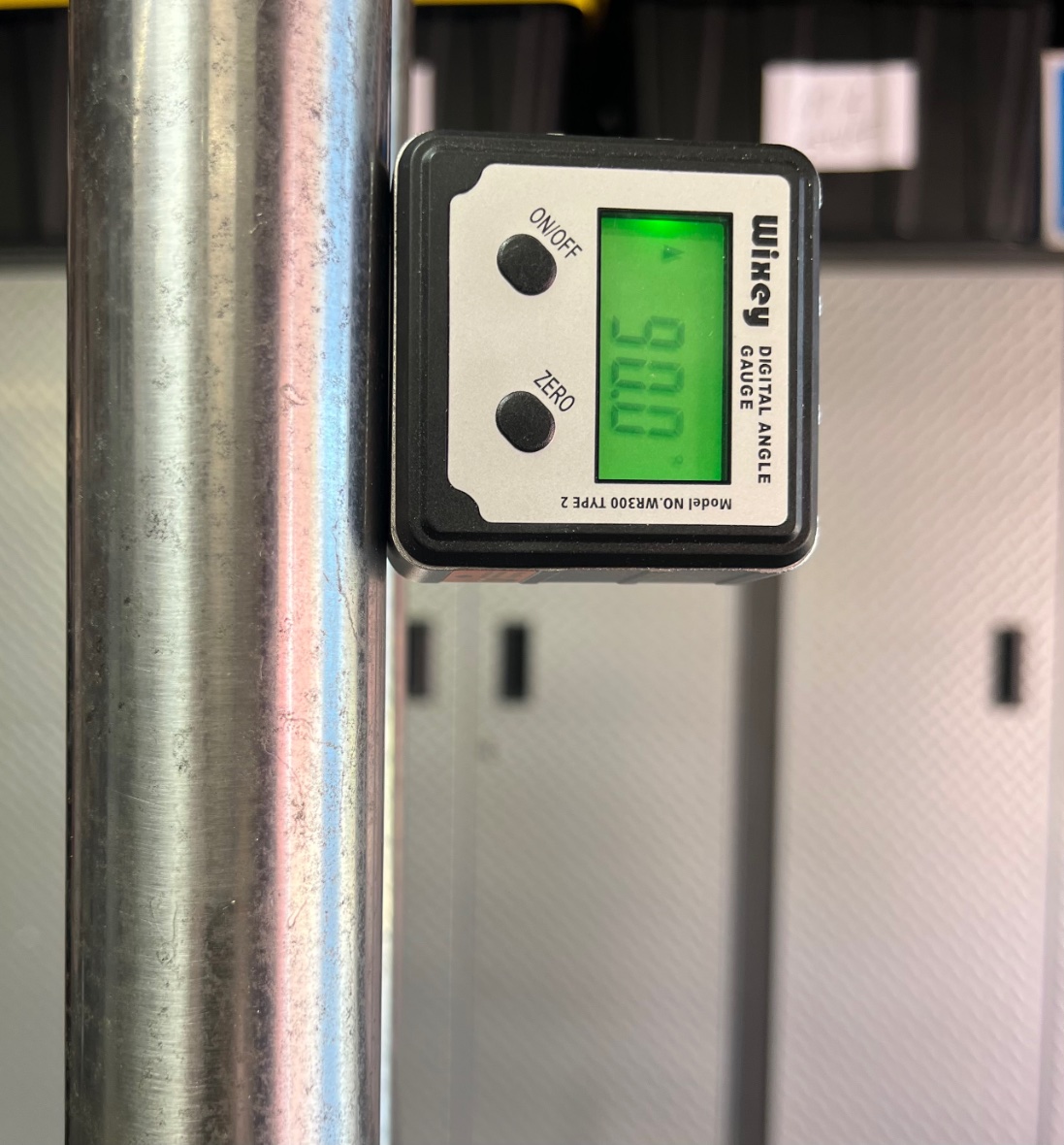

Pic of new adjusters. What’s cool about the Mark VII, and not happening on the Mark V, is it can be dialed in perpendicular to the machine top or table or whatever else you may need within reason. Full inch or so of adjustment. Sitting on a perfect 90 degrees with no weight. I know many don’t care but it makes me happy.

- IMG_2522.jpeg (343.54 KiB) Viewed 2753 times
- IMG_2521.jpeg (336.39 KiB) Viewed 2753 times
- IMG_2520.jpeg (294.92 KiB) Viewed 2753 times

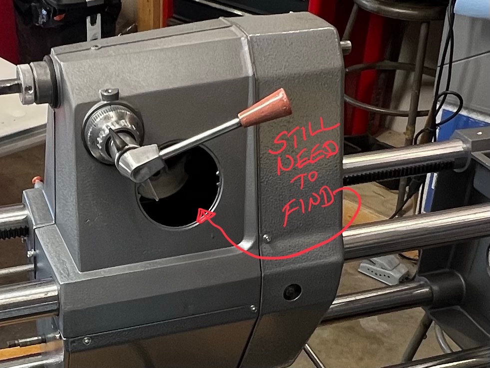

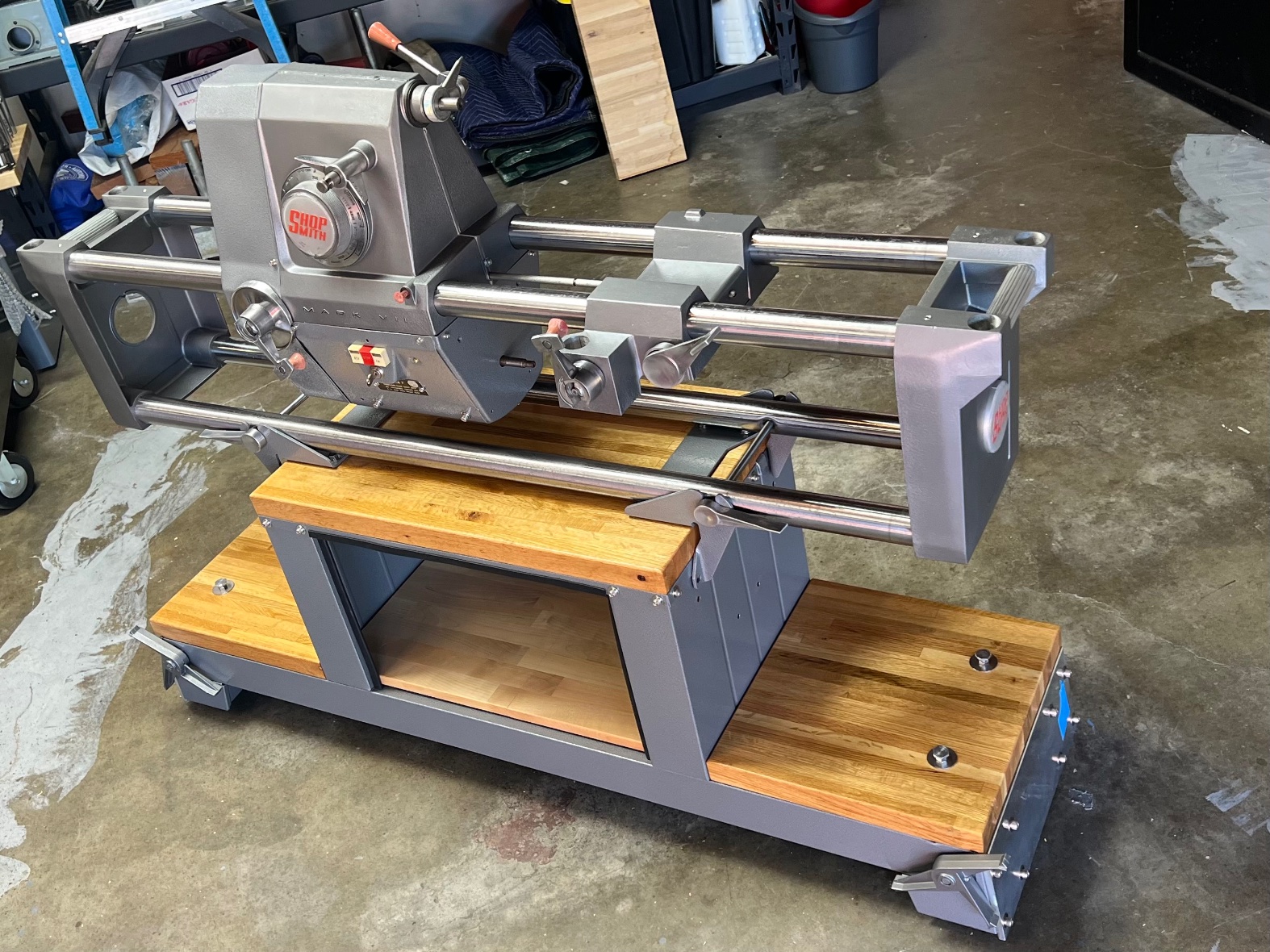

Where I am now and next pic will hopefully be completion
Parts still left to clean up (this part sucks)
Still need to find (1) access cover
- IMG_2525.jpeg (732.96 KiB) Viewed 2723 times
- IMG_2526.jpeg (592.99 KiB) Viewed 2723 times
- IMG_2527.jpeg (234.83 KiB) Viewed 2723 times
