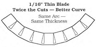

I also think that the converging grain pattern from your experiment #1 is much prettier. If you can hide the end grain, I'm thinking that you can get exactly the look you are wanting, without excessive sanding and shaping. First, glue up the deck with the grain pattern that you like, but glue it up flat. Then form the curve by "kerfing" the deck. Here's the general idea:
How to Master the Radial Saw, by Wally Kunkel (pp 63-65), has some very good info on this technique, including how to determine the kerf spacing to get the curvature that you desire. Done properly, the kerfs close completely at the desired radius of curvature. Fill them with glue, and you have a very strong structure. You could also use your end-grain-hiding piece to control the radius and reinforce the structure.
Here's a YouTube video that illustrates the kerfing concept.
[youtube]https://www.youtube.com/watch?v=g49H35ie2eQ[/youtube]
In both the book and the video, the "veneer" section (i.e. the thin layer of wood that is not kerfed through) is cross-grain to the kerfs. If it were parallel, I fear that the it might be too weak, and crack along the grain. For your deck, I'm thinking that the diagonal grain from the "converging" design should be sufficiently strong. Once epoxied (and especially if fiberglassed), it should be bulletproof.

BuckeyeDennis wrote:I also think that the converging grain pattern from your experiment #1 is much prettier. If you can hide the end grain, I'm thinking that you can get exactly the look you are wanting, without excessive sanding and shaping. First, glue up the deck with the grain pattern that you like, but glue it up flat. Then form the curve by "kerfing" the deck. Here's the general idea:
That's an interesting idea (and another technique I've read about but never tried). I think you identified the big question: whether the piece will crack at the kerfs with the grain running diagonal. Another experiment may be in order.
