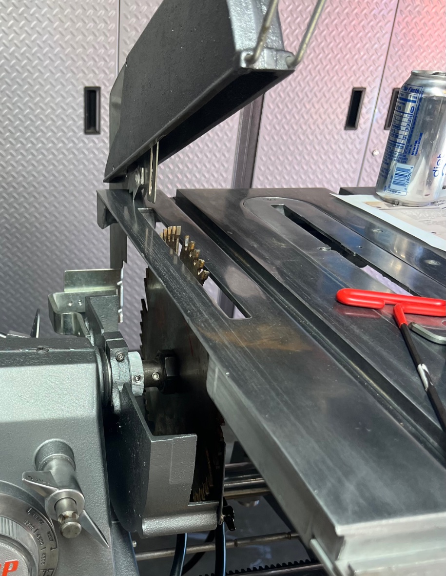

Getting close, was hoping to be finished…ran it and she runs beautifully. 800 RPM low end and 6000 or so high end and the dial clicks very smoothly. I was very happy, much nicer than my other machines. I have attempted to install upper and lower guard and was wondering about the following, knowing the parts I’m using are not necessarily for this model.
1. There is a slot about 3/4” wide on each side that would appear to let sawdust fly out of lower guard. Any idea what these slots are for?
2. The lower guard front plate just barely rubs on the blade. I read requirement is at least a 1/4” clearance. Do I have something installed wrong or is there a shorter arbor?
3. It appears there is still a lot of blade exposed and not a real good seal for dust. Is this just the way it is?
Many thanks for any assistance or clarification.

Is the quill shaft 1 1/8" proud of the collar? Looks sorta short????

I think you can slide the guard out some on the quill?
