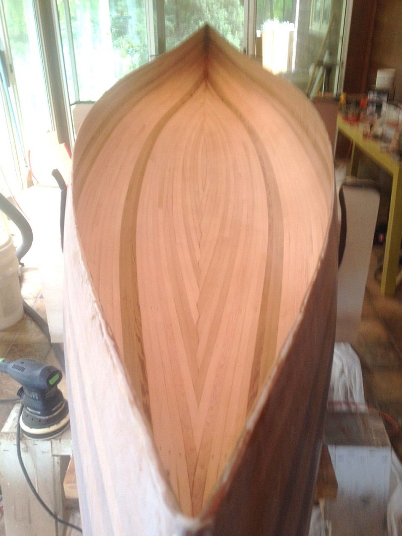

Re: A Slow Boat To Nowhere
A little progress.
Before:
After:
Before:
After:

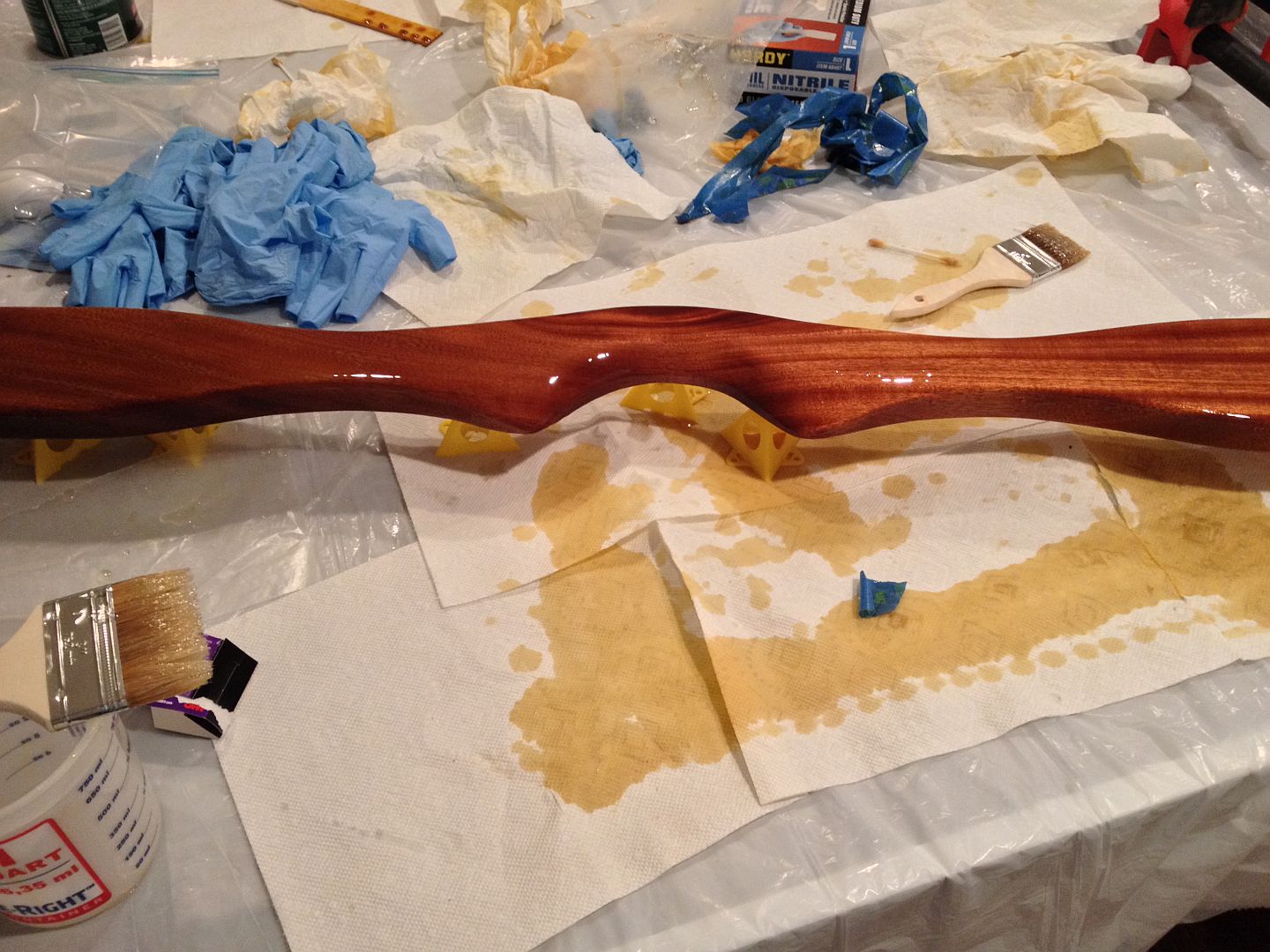

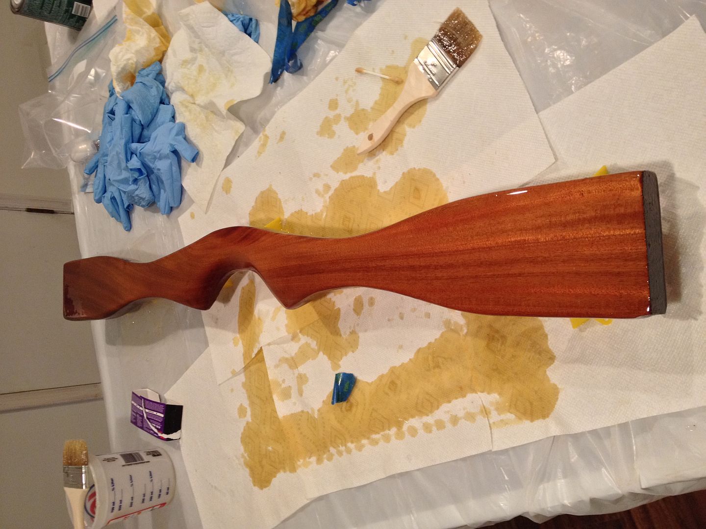

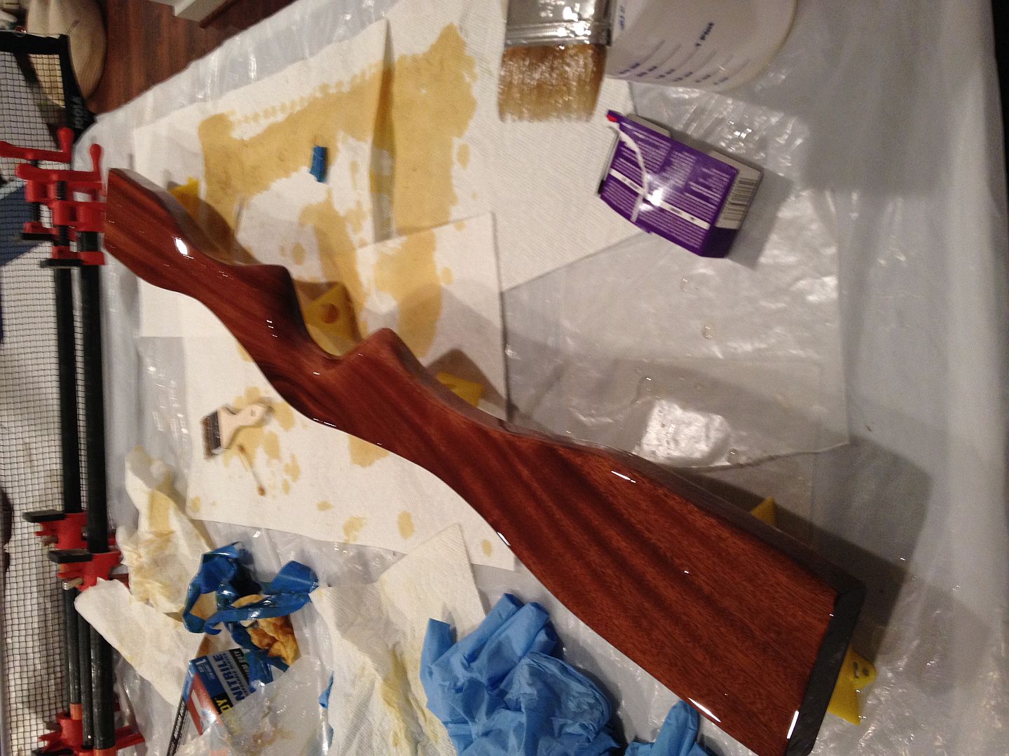

The thwart/yoke (this canoe only has one) has its first and second coat of epoxy.
The wood is Sapele (matches the seats) cut on the Shopsmith band saw. The scoop around the neck should be shaped with a spokeshave, which I don't have. Care to guess how I did it using Shopsmith equipment?

Quill mounted drum sander?algale wrote:The thwart/yoke (this canoe only has one) has its first and second coat of epoxy.

I guess I might have done it on the top end of the belt sander.
(I keep it in the vertical position)

I'm going to guess drum sander with the table tilted for roughing, and then the edges blended in freehand.
Shipwright nailed it. The yoke's scoop was done freehand on the top of the Shopsmith belt sander in vertical position with an 80 grit Shopsmith G2 belt that I picked up at Lowes a while back. Just went at it until it looked pleasing to the eye and felt comfortable on the neck/shoulders.

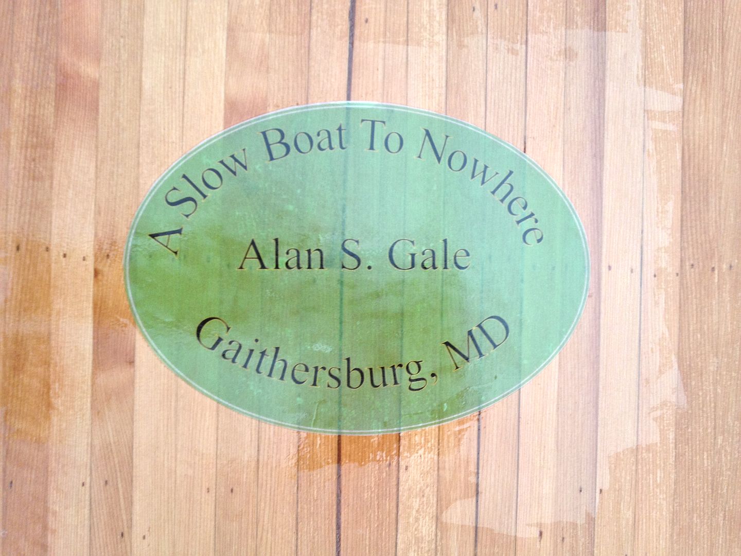

Almost forgot to add the name/vanity plate.
You thought maybe I would put a different name on her?
