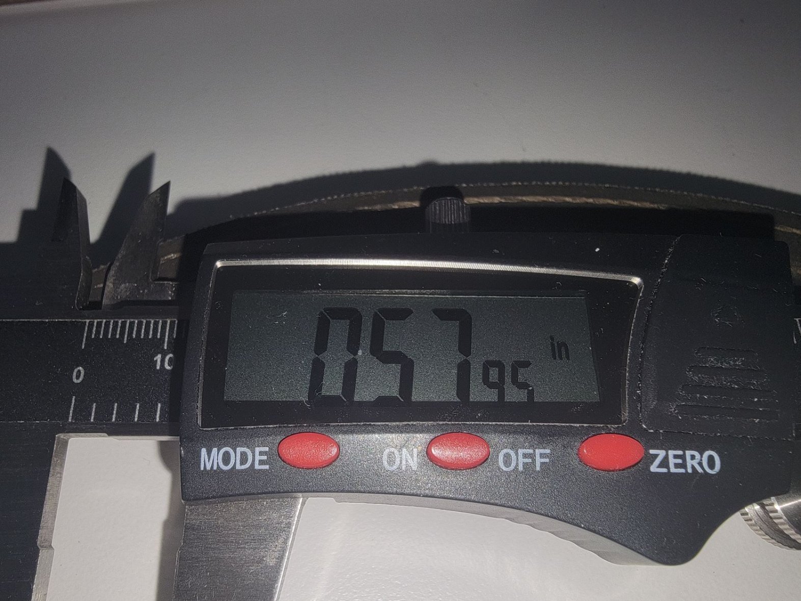

What are you using to measure a rubber belt width to .0001"?
[/quote]
An inexpensive Husky caliper.
[/quote]
- Husky Caliper.jpg (322.16 KiB) Viewed 3290 times

BS resolution
So did it get fatter?
