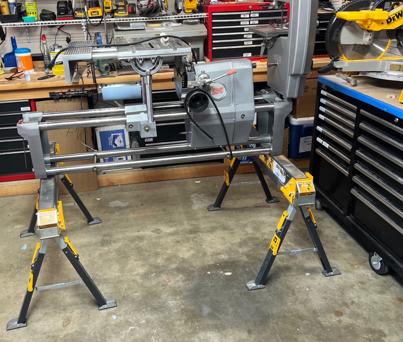

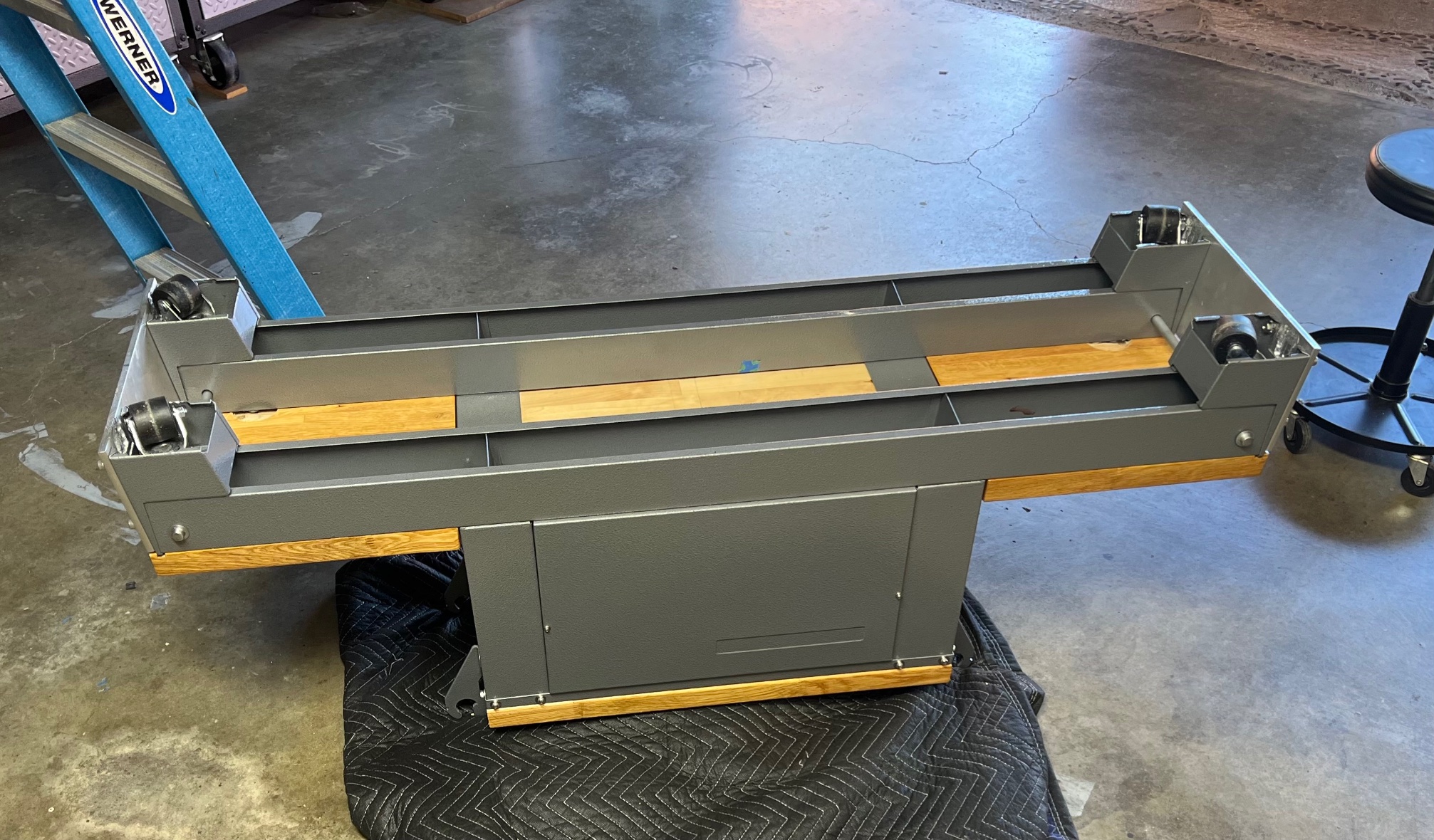

Had 1st issues with the wheel setup. The Tinnerman clips gave way holding one of the casters to the shoe. I pushed it hard thinking I was stuck in a rut and the wheel mount bent as it was folding over. Anyway just posting to say this machine is so easy to work on bottom half. The ability to tilt each way allowed me to put one and at a time on a saw horse and slip it out to work on it. Brilliantly designed. Ended up taking Tinnermans out and using SS screams washers and nuts.

Screams washer???
Re: Mark VII a start and a long ways to go..
Wasn’t screaming to loud so used SS “screws”, washers and nuts

Interesting. I just replaced the tinnermans on my Mark VII headstock as some were missing. I Helicoiled the holes in the casting and installed 10-24 bolts. I did the three on the speed control at the same time. My casters just needed cleaning and lubricating so I don’t remember but there likely isn’t enough thickness to helicoil there.
Anyway if you need tinnermans, they can be robbed from the cast headstock.
Threaded pop rivets may be a tinnerman nut replacement.
Both great ideas, I think I only have 2-3 remaining and now have additional methods. Thank my ou both!
