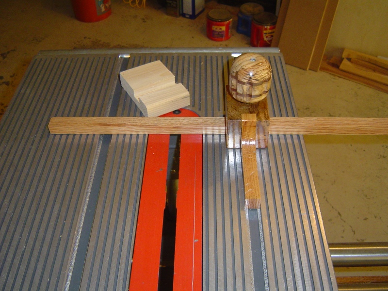

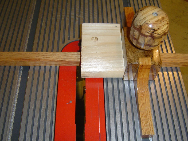

I finished turning the knob for this yesterday, so now I feel ok about posting the project. I found plans for this gauge in an old issue of Woodworker's Journal. The wood is all from a dead oak tree that I cut down last month, except for the bar, because I wanted to ensure stability, and two thin walnut strips in the knob. The guide base is finished with 6 coats of Minwax Wipe on Poly and the knob was finished on the lathe with Shellawax Cream.
I'll use the extra block of wood on the table with the dado cut to zero the blade. Uses for the gauge will be to ensure the table is square to the blade, the fence is parallel and as a stop if I need to cut multiple thin strips and want to move the fence after every cut.
I used the band saw to mill the logs, table saw, dado blade, jig saw, drum sander, disk sander, drill press and lathe. The only non-SS tools I used are a bow saw and chain saw for the initial cutting and to make one flat side for the bandsaw.

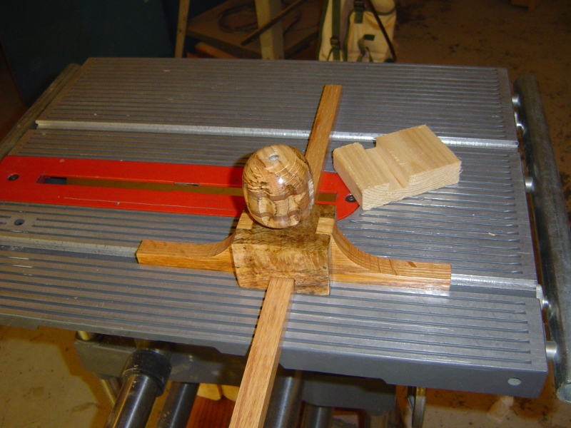

[ATTACH]12100[/ATTACH]
The wild grain on the main body of the gauge came from a crotch area. The camera didn't catch any of the highlights.

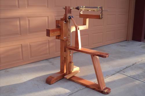

This is my latest baby. She cut her first veneers today and I am way more than impressed. Almost immediately I was making far more precise cuts than I could ever have hoped to cut with my DeWalt scroll saw. It's a copy of a machine introduced in Paris about 200 years ago that at the time revolutionized the art of marquetry. Mine is self designed after looking at photos on the web. It's not far off the original except for the fact that I have access to better bushings. She's a joy to operate.

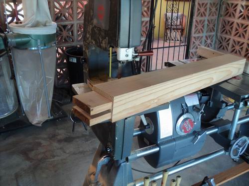

Almost all operations were done on my 510 here in Green Valley. It took about 40 hours and cost me under $100. Thanks to Gene Howe for the Bois d'Arc used in the saw frame and the mesquite in the knob and rocker rack. The rest of the wood was salvaged from an old beam I had to replace because one foot of it was rotten.

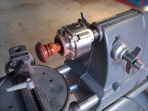

This is the mesquite knob. You don't actually hold it by this strangely. It's use is in springing the blade.

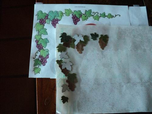

This is a little marquetry border I chose to try her out. The white bits are pattern paper stuck to some of the dark green veneers. It will come off after final glue-up.

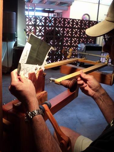

Looks IMPRESSIVE. I'd LOVE to see how it works. Is that a coping saw like blade that does the cutting?
- Posts: 35598
I had it figgered wrong! The arm with the 'skate' wheels is to apply clamping pressure by way of the foot platform. I assume only enough pressure is applied to briefly hold the workpiece on each stroke. The pressure is released to allow movement between strokes?
Very Interesting device! Thanks for the education!
P.S. Cut on the pull stroke?(while pushing with feet???)
- shipwright
- Posts: 1165
JPG, Release foot pressure, adjust packet position, re-clamp with feet, cut on push stroke, repeat. The control is amazing.JPG40504 wrote:P.S. Cut on the pull stroke?(while pushing with feet???)
camerio, I'm not much on videos but maybe I can talk Dusty into helping produce one.
Beeg, It's a 2/0 marquetry blade.(Jeweller's blades) The numbers work opposite to scroll saw blades so higher # means smaller blade. However this is smaller than any scroll saw blades.
Paul M

how do you make the twist? im new to the whole lathe thing and id really like to know how to do that-mike
