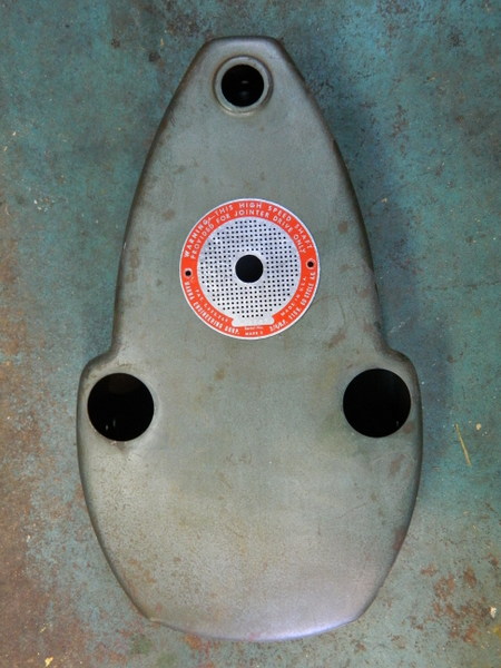

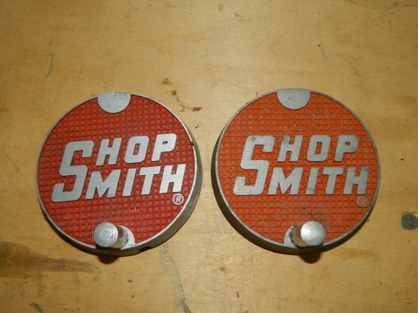

I've managed to do some work on the restoration projects in between other things. And some thanks are in order- a new vent cover plate for the Greene aka SS55 courtesy of JPG. Here's a preview:
[ATTACH]16987[/ATTACH]

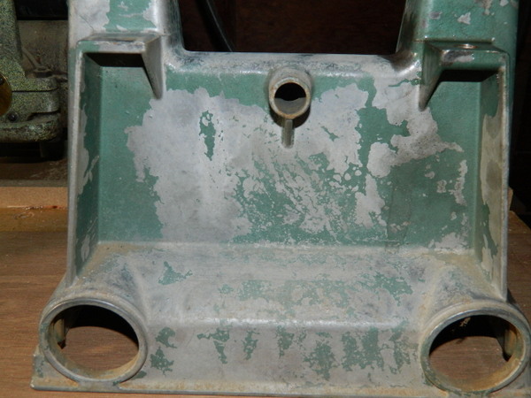

Weather is warming up finally and the special order of Verde Green has arrived, so painting will happen soon. What's left of the original green paint is pretty much falling off. I'm going to get it to bare metal without too much trouble and then I am thinking to use the self etching aluminum primer from rustoleum. I'm used to seeing more tenacity on original paint on old machines- maybe the old paints didn't like the aluminum:
[ATTACH]16989[/ATTACH]
(It almost looks like one of the old asian landscape paintings to me). the paint comes off in some spots just with brass wire brush, though I'm planning to use citrus strip.

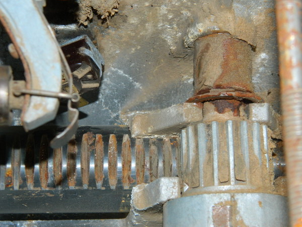

I found a bunch of compacted sawdust in SS79- I image that's pretty typical. It took some doing to get the quill out of this one, patience and penetrating oil:
[ATTACH]16998[/ATTACH]

Typical? Perhaps. Normal? No!cranehead wrote: . . .

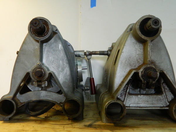

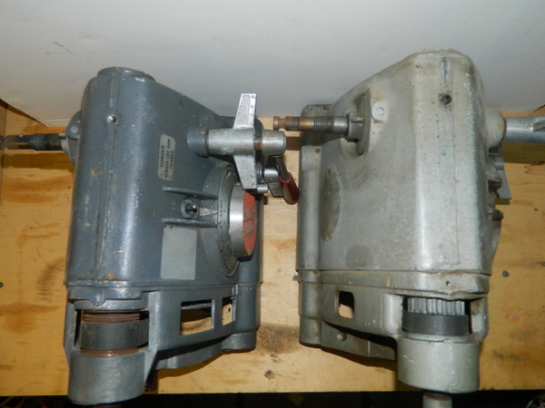

Since I now have two headstocks of different vintages on the bench at the same time I took the opportunity to take some pics comparing the differences. The contrast between the older and newer casting especially interests me.
Here's one:
[ATTACH]17116[/ATTACH]

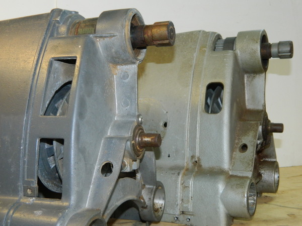

I'm not sure the pictures really show how much beefier and rougher the older casting method is. Maybe this is better:
[ATTACH]17118[/ATTACH]
In this one you can see how much thicker the ribs are in the casting:
[ATTACH]17117[/ATTACH]

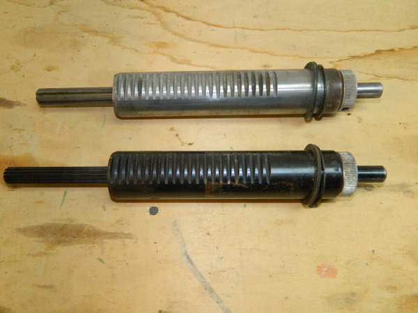

The two quills, the black one of course being the newer version, you can see it has more splines and is longer.
[ATTACH]17119[/ATTACH]
This pic shows the difference in color between the newer and older speed control- the older looking more oxidized, like old vw bugs look that were red once upon a time. the older speed control is pretty chewed up. Probably send it out to be rebuilt.
[ATTACH]17120[/ATTACH]
I'm sure that was a more vibrant red originally
More to come.
TC
Here's one:
