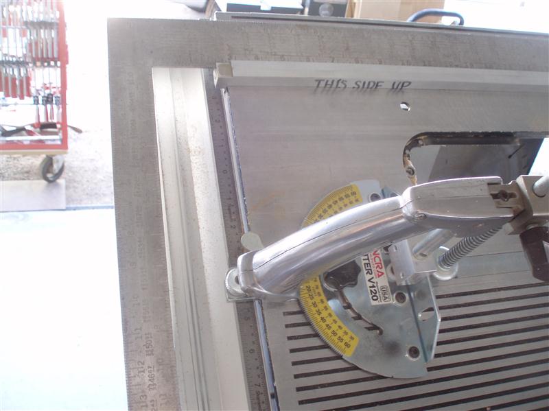

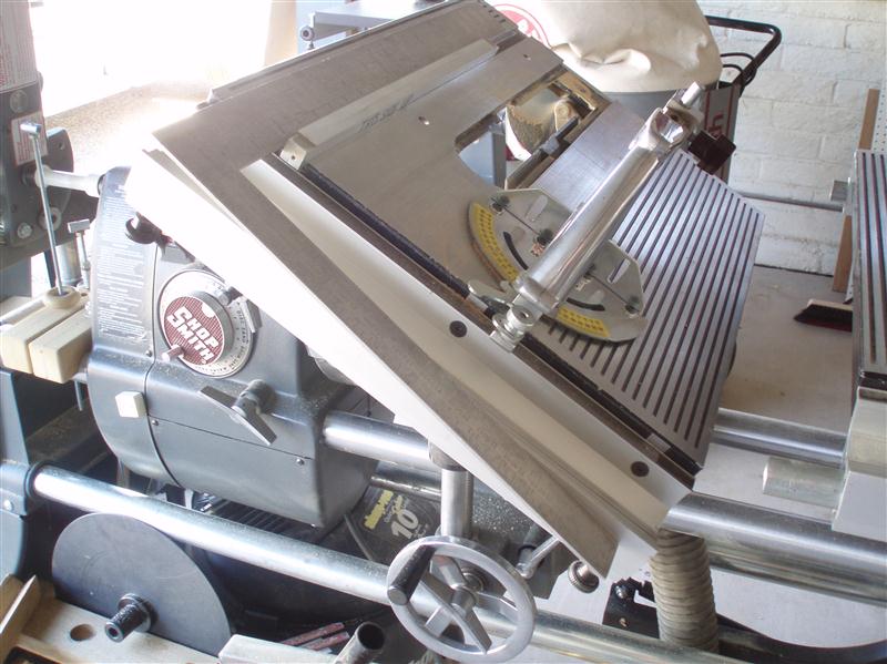

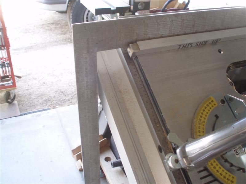

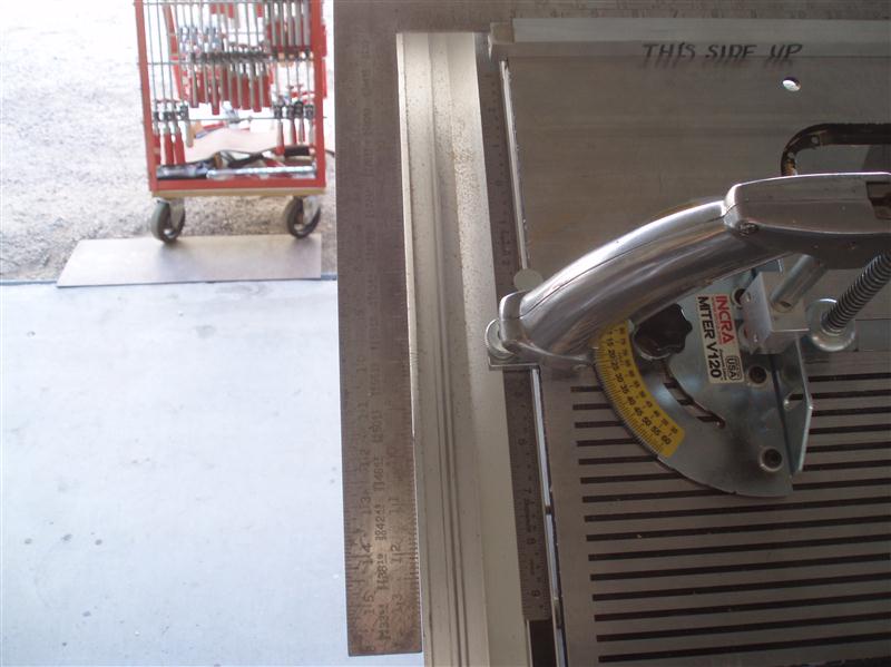

Very Interesting.
To test that theory:
[ATTACH]17812[/ATTACH]
[ATTACH]17813[/ATTACH]
[ATTACH]17814[/ATTACH]
[ATTACH]17815[/ATTACH]
- Start Here (Custom).JPG (57.76 KiB) Viewed 2095 times
- Then Here (Custom).JPG (85.82 KiB) Viewed 2091 times
- Then Here 2 (Custom).JPG (61.96 KiB) Viewed 2095 times
- Final Test (Custom).JPG (60.53 KiB) Viewed 2096 times
Thanks, Jim. In response to your first question, yes the table has been aligned to the blade using a dial indicator in the miter slots referencing off of a tooth (actually a gullet) on a blade.fjimp wrote:I admit to not having followed the entire thread yet noted two questions occurring in my rather simple mind. First have you checked whether the blade itself is square to the main table? Secondly have you used the shims provided by Shopsmith to check how parallel the front and back extrusions are to the table tops? I assume this has all been verified so will apologize in advance for blubbering. Jim
In response to your second question, I assume by shims you are referring to the aluminum thingy that Shopsmith sends. If so, the answer is yes. In fact, over the last two days I have carefully checked and realigned as necessary the front and rear fences on all the tables. They are now all very well aligned to the table tops and in the same vertical plane. Now the story is different in the horizontal plane where there is a slight catch and that may be enough to be the problem because, as Ed points out above, a very slight horizontal misalignment of the rail will translate to quite large error over the length of the fence.
