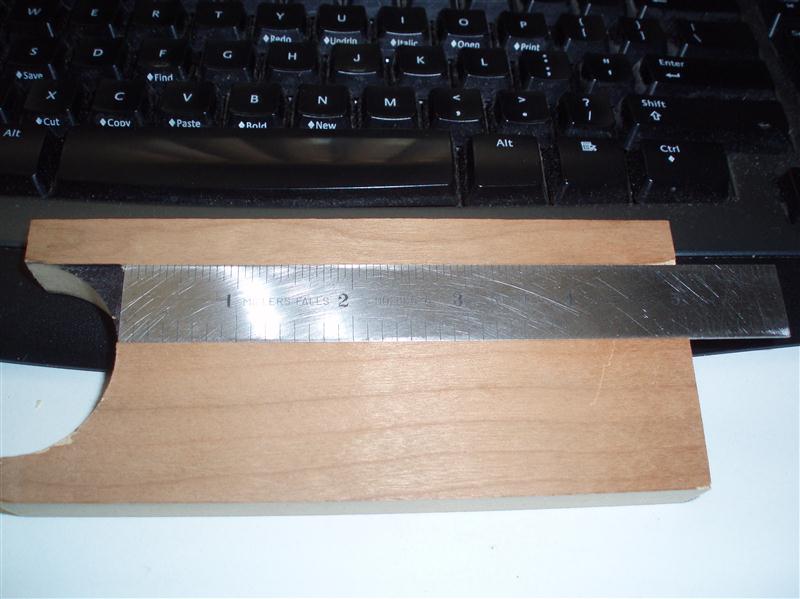

I was using two framing squares which was a bit clumsy.
I did these measurements using something else.
[ATTACH]18091[/ATTACH]
The idea is consistent from measurement to measurement.
New Jig 002 (Custom).JPG (59.28 KiB) Viewed 1845 times
dusty wrote:I was using two framing squares which was a bit clumsy.
"distance from top of WAY tubes to underside of WAY tubes"???
JPG40504 wrote:"distance from top of WAY tubes to underside of BENCH tubes"???
