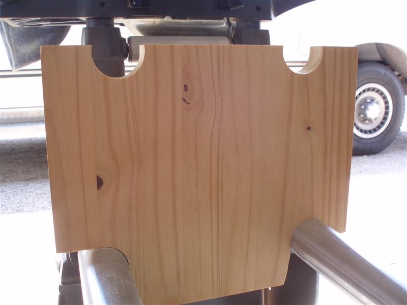

To try to understand this, I built a simple jig that serves as a "Caliper for the Way and Bench Tubes".
[ATTACH]18073[/ATTACH]

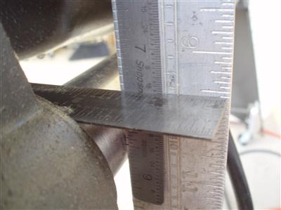

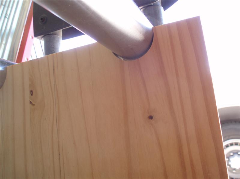

With this caliper I have convinced myself that there is something different about one of my two Mark Vs. In one the tubes rest exactly like you would expect but in the other there is a gap.
[ATTACH]18074[/ATTACH]
Left End of the Shorty
[ATTACH]18075[/ATTACH]
Left End of Unmodified Mark V

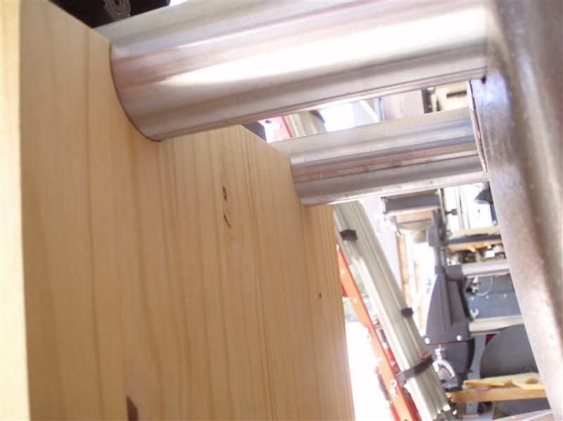

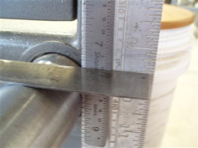

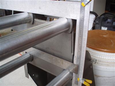

Contrary to my longtime assumptions, the bench tubes are not parallel to the way tubes. I don't know if this is by design or if my two machines are screwed up.
[ATTACH]18082[/ATTACH]
Right End
[ATTACH]18083[/ATTACH]
Left End
[ATTACH]18084[/ATTACH]
Right End
Left End

I do not understand this test set up and how it demonstrates a lack of parallelism between bench and way tubes.dusty wrote:Contrary to my longtime assumptions, the bench tubes are not parallel to the way tubes. I don't know if this is by design or if my two machines are screwed up.
[ATTACH]18082[/ATTACH], [ATTACH]18083[/ATTACH]
