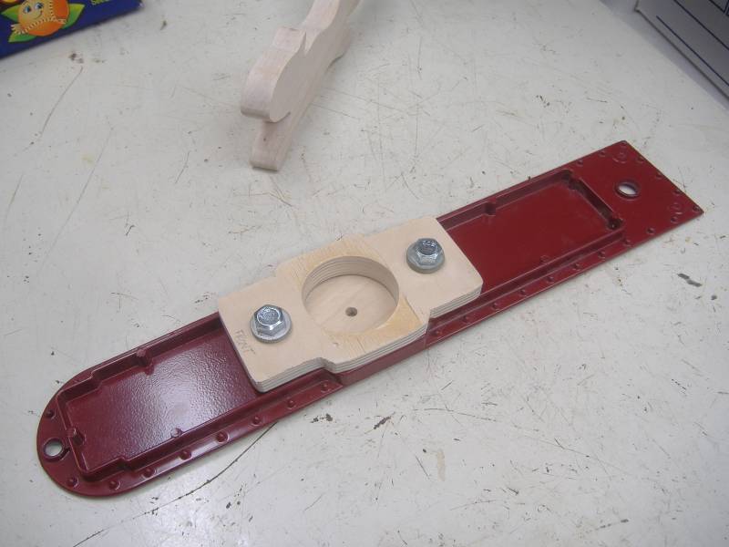

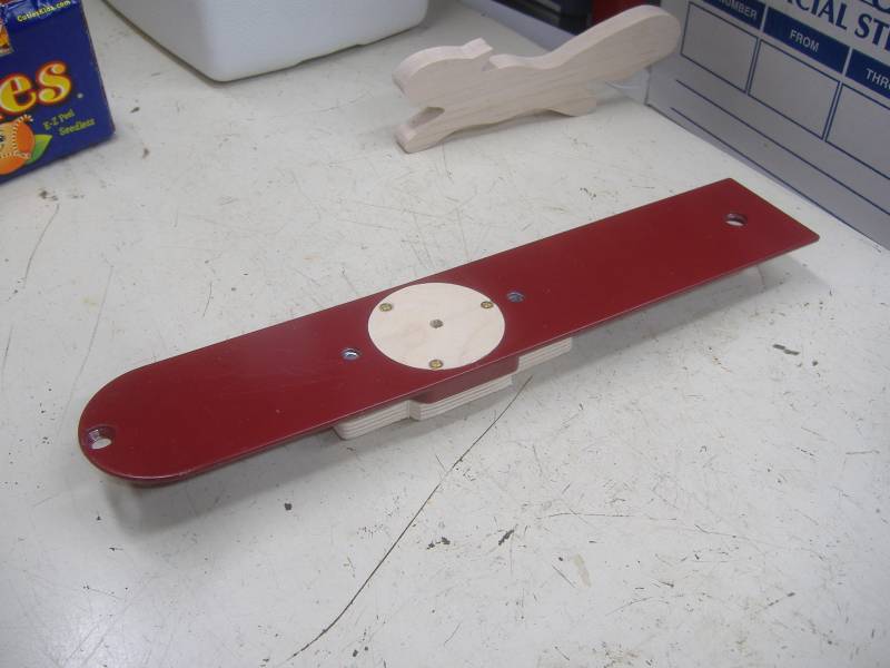

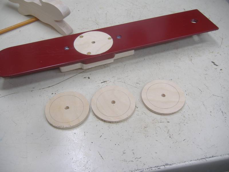

Just a short update on today's efforts.
I prototyped an insert that is designed to use the shaper table inset and provide better support near the bit then is presently being offered by shopsmith.
I'll let you see what it looks like but I know I need to make a few adjustments before I start testing with live bits.
I think pictures will be the best way to go here sooooo
[ATTACH]19461[/ATTACH]
[ATTACH]19462[/ATTACH]
[ATTACH]19463[/ATTACH]
The inserts are not drilled out yet, the sizes will be 2", 1-3/4", 1-1/2", and 1-1/4".
The material that I had on hand for the inserts was some 1/4" birch plywood, that is not going to work. I broke one already so I have to find some tempered hardboard or similar material to use. I have some scrapes I'll have to dig out... Other then the material issue it is looking promising.

I would like to read more if you have made any progress. Today, I tried my Mark 7 in router mode for the second time. Mine seems to max out at 9500 rpm. I guess that is close enough to 10,000.
I tried to route some saw table inserts made from 1/4" birch ply, covered with formica. I thought that I could just drill various sized holes in them for different router bits. I found the SS table lacking; working with a small object, I thought the table was too uneven.
But I plan to try again.
Tom in Helena, MT
