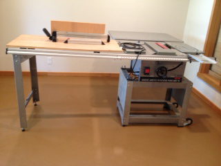

worknhard wrote:The Incra equipment is very nice. If you need to make high accuracy cuts, it looks like their product will save you time and give repeatability. When I designed the interface hardware to adapt BT3000 parts to the 510 (what I call my Shopsmith 3000) I wasn't trying to duplicate what Incra has, instead my intention was to make the 510 a much more versatile saw. Having spent many years using the BT3000 I grew very accustomed to its unique features. When I acquired a Shopsmith 510 and began using the table saw function I felt I was going backwards. Don't get me wrong, the Shopsmith indeed has lots of desirable features and is versatile, that is why I got it in the first place, however, the table saw I felt left a lot to be desired. I missed what I had with the BT3000. This is what motivated me to adapt the BT3000 components to the SS. I knew that if I could adapt the rails to the SS table I could carry over many of the other desirable features such as]19496[/ATTACH]

Ed -- I suppose you could consider the nylon slides a weak link, but that is not necessarily bad thing. What I mean is, in order to have a smooth sliding table and offer fine tune adjusting, and be affordable, nylon was the material of choice for Ryobi. The slides are replaceable and inexpensive (about $1 ea.), and are not that difficult to replace and adjust, IF YOU FOLLOW THE INSTRUCTIONS. In my opinion, the bigger problem with the nylon slides is breaking them thru mishandling. If you pull up on the sliding miter table base trying to lift the saw, or toss the sliding miter table around when it is off the saw, you risk breaking one or more slides. One thing I can say however, is once the slides are adjusted properly they usually stay that way. My BT3000 is about 18/19 years old and I have not had to replace the slides yet.
As far as difficulty in fabricating the brackets to adapt the rails to the SS table, it took me a couple attempts thru building prototypes to finally get it right. Pretty tight tolerances need to be determined and maintained in the fabrication process. This was very difficult because I had to account for manufacturing variance (at least the best I could determine) in both the BT3000 parts and the SS table. I spent a couple years playing around with the design before I finally got it the way I wanted.
Yes, the parts off the Sears saw, both the new and older versions that mimic the BT3000 will work.

There is an adapter plate that Ron designed and has produced that bolts to the Shopsmith 505/510/520 tables using the holes that would be used for Shopsmith rails.
The Ryobi rails fit on and bolts to that adapter plate. The rails are attached to the adapter plate using the same style t-nuts as does the BT3000. This mounting method allows the Ryobi rail to be positioned (left/right) on the table.
With regard to the Sears version of the BT3000; I believe they are interchangeable. I come to that conclusion by reading posts from users on the btcentral user site (a forum for BT3000 users).
