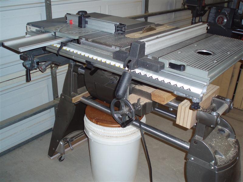

[ATTACH]19477[/ATTACH]
This is my Shorty with an adapted floating table, the SMT, an adapted Main Table and the Router/Accessory Table all mounted to Ryobi rails. Note also that I have the jointer mounted as well (with no power adapter).
SAFETY NOTE: Seldom if ever is it appropriate to utilize both the rip fence and the cross cut fence simultaneously as shown is this picture.
