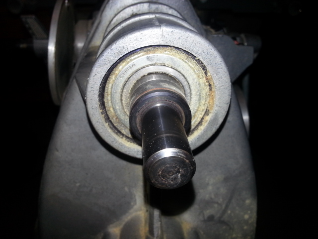

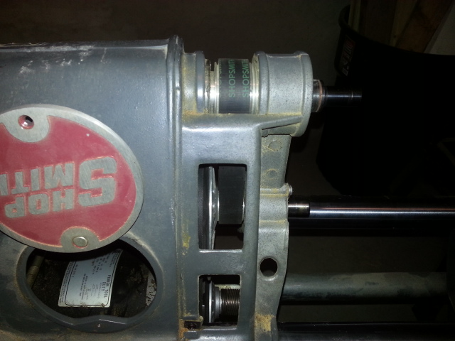

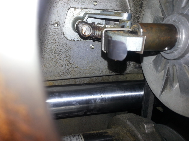

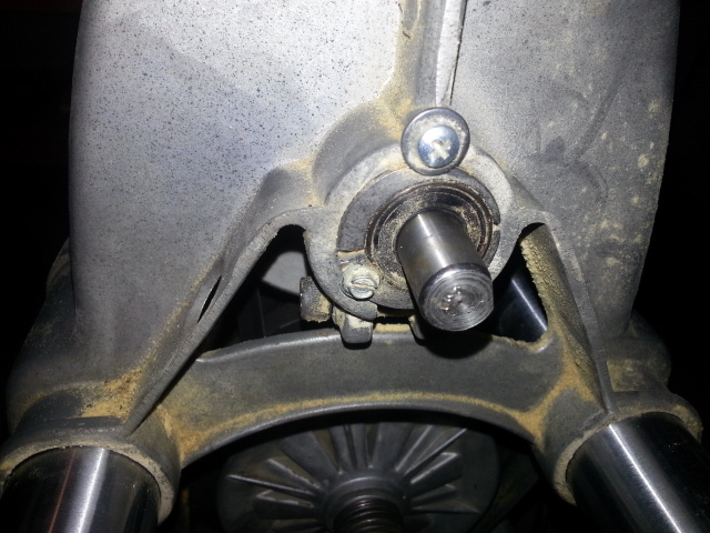

Okay, JPG, I will get you some pictures as soon as I can and you can tell me if these are what you want. I don't know if I will be able to upload any pictures it seems as my pictures are too large. I did want to add that I have another head stock with the red start switch. It does not have a serial #. So I'm presuming that it is a ninety something head stock. There is no click when I shut it down or when I turn the motor sheave by hand. The head stock in question the click is coming from the idler shaft. I determined that by rotating the drive sheave and putting my finger on the idler shaft. And like I said before the click is intermittent.
