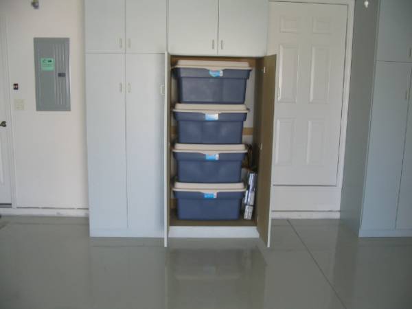

I have used MDF for some garage cabinets without any problems YET. For joining panels at right angles I use dado joints. The upright cabinets are 96" tall and are still OK after 6 years although they have been painted with a semi gloss latex paint.

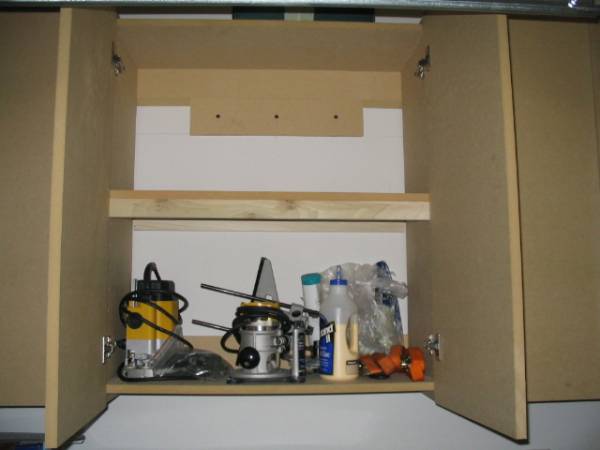

The wall cabinets are unfinished but the edges of the shelves have to be supported by a solid piece of wood (in this case poplar) to accept the load.
[ATTACH]23807[/ATTACH]
The wall cabinets are attached to the concrete block using the French cleat method
[ATTACH]23808[/ATTACH]

Really nice looking storage area. It looks great.wa2crk wrote:I have used MDF for some garage cabinets without any problems YET. For joining panels at right angles I use dado joints. The upright cabinets are 96" tall and are still OK after 6 years although they have been painted with a semi gloss latex paint.

The load that you are putting on the shelves will probably not stress the shelves. Your storage containers help by distributing the weight toward the ends of the shelves.

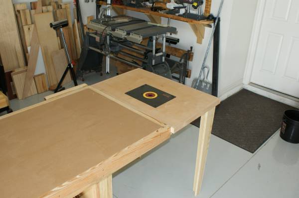

MDF does stay flat and when finished with a couple of coats of polyurethane it looks good too. My main bench top is two thicknesses of MDF and two thicknesses of MDF about 8" wide around the underside and then banded with some southern yellow pine. I added a router table top to one end.
The frame is also SYP. Not very expensive to build and is VERY heavy so it doesn't move when pushed on.
[ATTACH]23814[/ATTACH]
The plans were downloaded from the Woodsmithshop TV show
