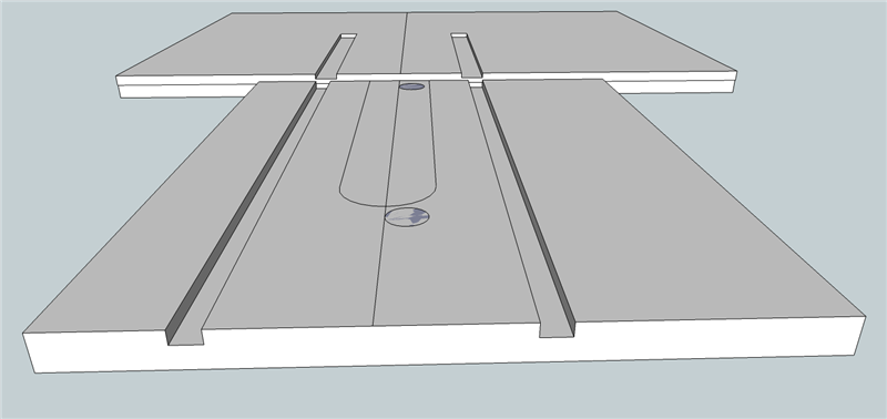

As the table is tilted, it stutters/shimmies/vibrates due to the tables needing to shift relative to each other due to the 'uncommon' pivot points.Ed in Tampa wrote:What is out feed table stutter?
Table Tubes vs Trunnion Pivot Point
Dusty: Not sure who Alan is, but if you look back to post #10, you will see that the M VII has the pivot and the posts with no offset. The M VII table tilts 90 degrees in both directions. The pivots being below the table allows room for the stop screws etc. i.e. The post/pivots are NOT offset from each other. It does require that the blade slot be offset(the blade is further from the tie bar).

He is still thrashing over why the post/pivot offset, but we may never know absolutely why that is. Only the Mark VII has them 'aligned'.

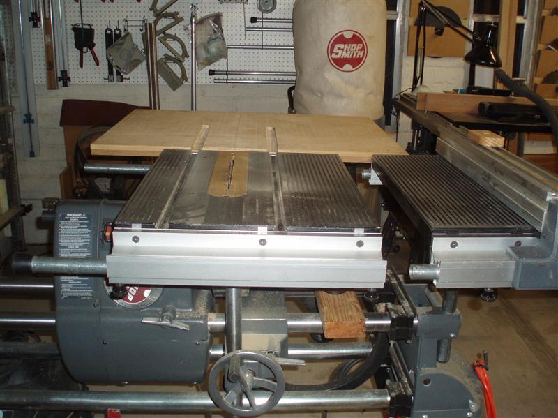

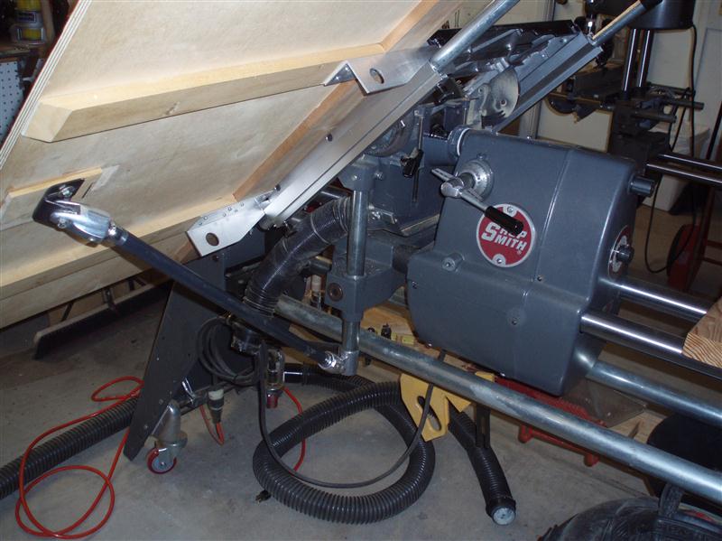

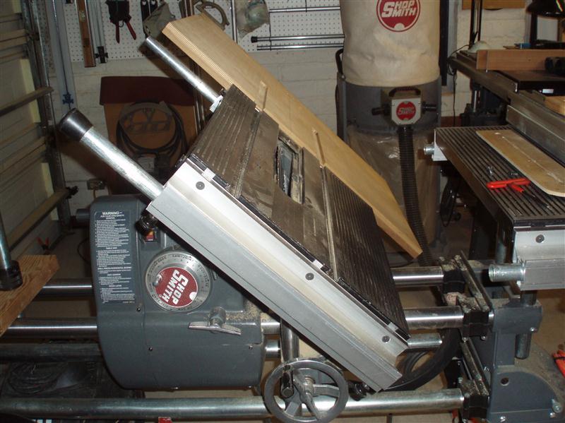

Congrats! I figured that you were going to get there sooner or later. Care to share the secret of your success!dusty wrote:[ATTACH]20231[/ATTACH]I'm done. It works.
algale wrote:Congrats! I figured that you were going to get there sooner or later. Care to share the secret of your success!
It is no secret and in the eyes of some it is no success. Then there are also those who just don't give a flip because they don't have and/or don't want an outfeed table that tilts, raises and lowers with the main table.
The critical issue is getting aligned with the Main Table Pivot Point. I began this entire venture thinking wrong]20232[/ATTACH]
[ATTACH]20233[/ATTACH]
[ATTACH]20234[/ATTACH]
