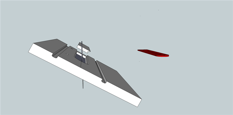

I am currently taking some meds that make me feel a bit rummy so I cannot do this for real. Instead, I spent some time doing it in Sketchup.
Yes, shipwright, you are absolutely correct. It can be done with the Main Table tilted to 30°. Furthermore, there is no significant hazard (except to the rip fence) presented by doing this.
To do this for real I believe it might be necessary to install a sacrificial fence to save the rip fence. Without that protection the blade gets uncomfortably close to the rip fence.
[ATTACH]22368[/ATTACH]
For this Sketch, I made the first cut with the rip fence (not shown) on the right side of the blade and the table adjusted for 3/4" depth of cut. Then the second cut would be made with the fence having been readjusted away from the blade and the table readjusted for proper depth. Depth of cut settings here are critical to a successful bird mouth.
DO NOT TRY THIS without a table insert. In fact, if I was going to do this I would create a custom insert.
Shopsmith Main Table with Table Tilted (Custom).png (29.69 KiB) Viewed 920 times

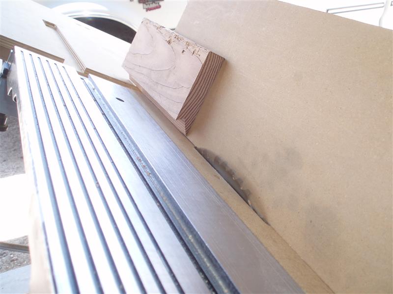

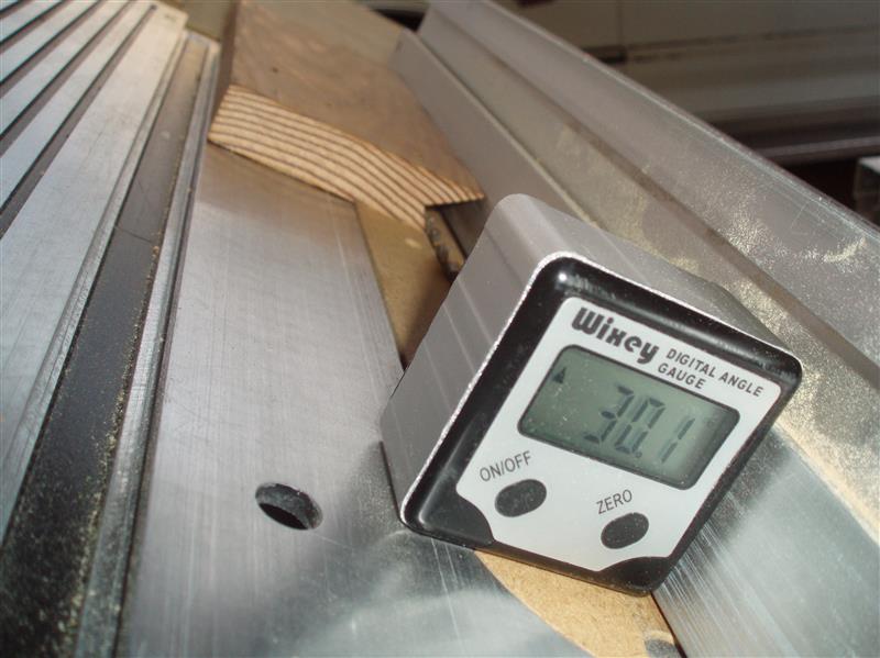

I got yelled at for doing this while taking these meds but I could not resist. I only cut a short piece. I dare not make sawdust anymore today.
[ATTACH]22371[/ATTACH]
[ATTACH]22372[/ATTACH]
I did cut a special slot (at 30°) in one of my previously used table inserts.
farley: At first I read your post as 12'. Cutting a birds mouth at 12" doesn't even necessitate an outfeed table.
Side Comment: I sure wish I had a shed full of wood identical to the cutoff I used for this birds mouth.
Birds Mouth Joint 001 (Custom).JPG (65.72 KiB) Viewed 903 times
Bird's Mouth 003 (Custom).JPG (59.23 KiB) Viewed 901 times
Sheez! Where was my jr high geometry 'knowledge'?:o
60° on one side of the blade = 30° on the other side!:cool:
Thanks Dusty for walking out on the plank!;)

Thank you and I am glad that I saved you the time. As I sat here thinking about the task I just could not help myself. I had to make the cuts to convince myself.
I made the one cut (not pictured here) without a sacrificial fence but again - I do not recommend that. The slightest movement of either, the headstock, the table or fence could bring on disaster. Disaster that can be so easily avoided with a sacrificial fence.
Don't do as I did.
