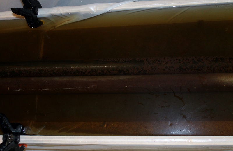

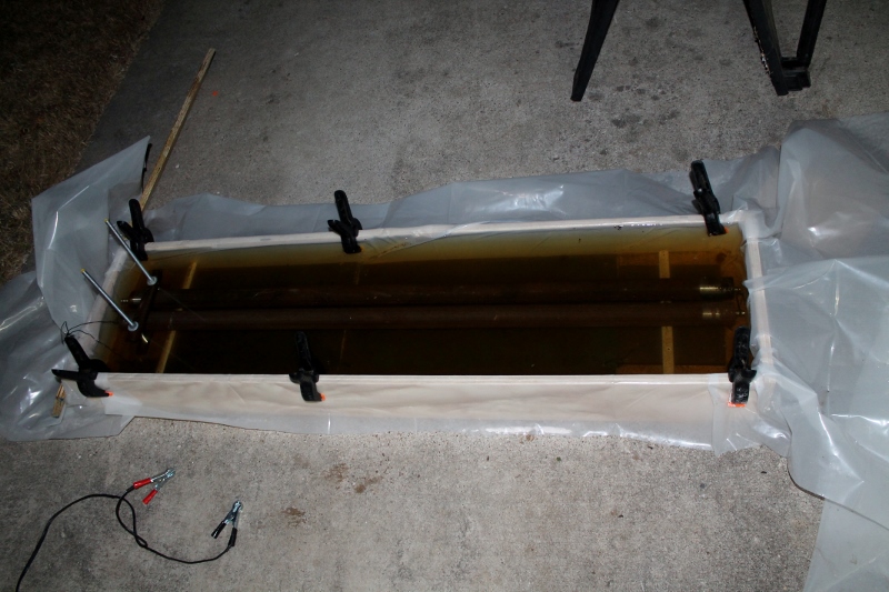

4:30 AM, this is the new box about to get fired back up. I haven't been running it unless I was awake and at least in the house because A - I don't have a ton of experience with chargers/electrolysis and B - the charger was making intermittent popping sounds. Not sure what that means but I wasn't taking the chance.

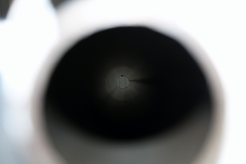

After rotating the tubes to get the tops handled. I ran a finger over the tubes and this shot shows that the rust just kind of sloughs off. What it also shows is that one tube has apparently had no electrolytic reaction and I'm not sure why.

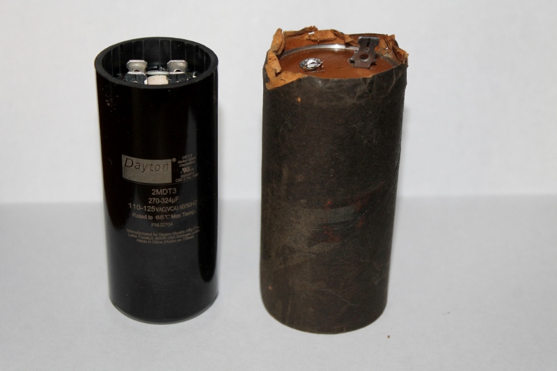

New and old capacitors for the motor.

I don't need the expense. However, that was based on an assumed $400 price tag and the feeling the current motor just needed the capacitor. Between hearing the bearing squeal and Bill's great service I changed my mind. I figure it's a one time upgrade and it ensures we'll have good performance for years to come.

It's a dumb charger. Looks like the brackets I used to hold had enough rust on that side to prevent the flow. I removed the other tube and let it cook alone, no problems then.

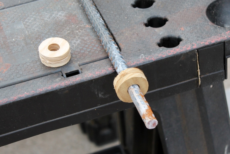

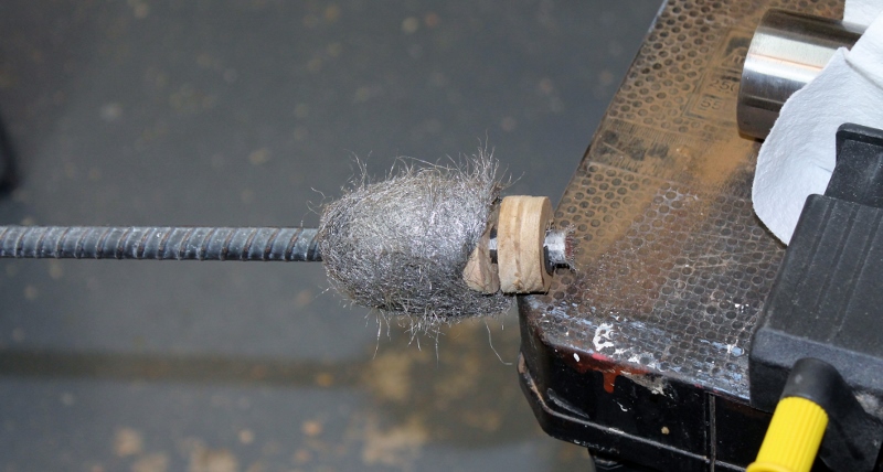

I managed to get the bench tubes through electrolysis before the weather set in. I thought myself clever to cut out some circles and use them to put rebar in the tubes to remove any rust there. I realized that I needed to do something to clear that stuff out as well so I added some other circles and used the setup as a ramrod. Chucked up the rebar and ran steel wool, a cleaning cloth and then JPW through the tubes. Looks pretty good in that last picture.
