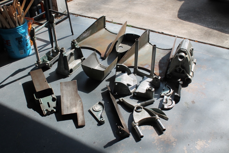

I'm not going to rush this because, well, I won't have the time to even rush it. Between work and kids I'll be lucky to get a couple consistent hours each week. That said, I got a good day this weekend and was able to start the Citristrip. For anyone wondering, yeah that stuff works.
Bad before picture:
[ATTACH]24016[/ATTACH]

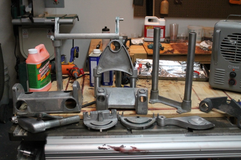

Better after picture (about half the items done):
[ATTACH]24017[/ATTACH]
I had my space heater running just on the right side of the frame and used that to drive off any lingering moisture. Some items still have paint, particularly the newer tie bar, and I'll either wire wheel them or let them sit with more Citristrip longer. The remaining parts include the headstock, legs, jointer, and a few base/carriage pieces.
I also got some parts into the evaporust (off-brand actually) and scrubbed parts down to remove dirt. Pretty happy with that, got some pretty rusty parts back out as bright silver and then put them all in an oven at 175 to dry them all the way out. I chucked up a cleaning wheel in my drill and worked on on of the table bolts; I was surprised to see how shiny it got. I may have to rethink the notion of bringing parts up to a shine if it's this simple.

Bad before picture:

- SS Week 2 001 (800x533).jpg (276.9 KiB) Viewed 5425 times
- SS Week 2 003 (800x533).jpg (262.77 KiB) Viewed 5429 times
