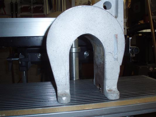

I have come to the "unscientific" conclusion that this will not be practical for most of the proposed applications. It may work for applications that utilize a mag switch. I don't have one but I assume the field strength is much greater than any of the magnets (other than the maggie) I have to test with.
Supporting information: When I position the magnetron magnet beneath the table it grabs onto anything magnetic on the table top (the table does not appreciably diminish the magnetic field strength).
[ATTACH]24980[/ATTACH]
- magnetron magnet (Custom).JPG (36.89 KiB) Viewed 1628 times

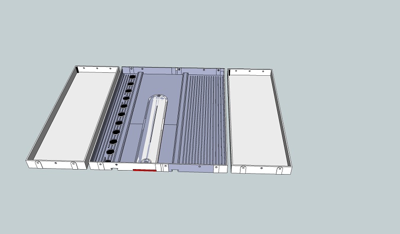

Last night I placed a couple 1/2" rare earth magnets on either side of the table insert opening to see of they might hold my Wixey depth gauge in place. There is enough holding power (without being too strong), but because of the webbing enforcement on the bottom side. I can't place them in the center line. I've decided to get some 1" magnets to see if they would have enough power to keep the gauge centered,
but that got me thinking about Gene's needs and wondered if a row of approximately 10 1" or larger magnets glued front to back would give enough of a field to hold the Magswitch. There are webbing structures, but I think something similar to this could be done
[ATTACH]24981[/ATTACH]
I haven't looked for a source for rare earth magnets larger than 1", but maybe larger would be better??
Thanks to Dusty for his drawing

benush26 wrote:Last night I placed a couple 1/2" rare earth magnets on either side of the table insert opening to see of they might hold my Wixey depth gauge in place. There is enough holding power (without being too strong), but because of the webbing enforcement on the bottom side. I can't place them in the center line. I've decided to get some 1" magnets to see if they would have enough power to keep the gauge centered,
I haven't looked for a source for rare earth magnets larger than 1", but maybe larger would be better??![]()
Be well,
Ben
You weren't suppose to flip it over to see the unfinished bottom side.
