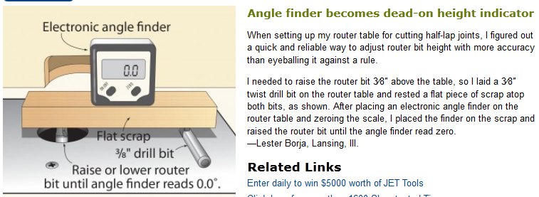

How about setting the blade/tool heights with this tip:
[ATTACH]24968[/ATTACH]
- tip.jpg (63.72 KiB) Viewed 2295 times

Interesting use of a cube I had not seen before. If I had a drill bit the diameter of the depth I wanted to cut I think this would be an option. I have used a drill bit to set the distance from blade tooth to the fence. Now, if I have a standard depth / width. I use the Kreg setup bars. I was given a set of the brass setup bars, but they were too fragile (especially the smaller ones) for my clumsy fingers.anmius wrote:How about setting the blade/tool heights with this tip:
I've found the Wixey digital depth gauge to be quite nice when it comes to non-standard cut depths(though it does go through a battery every couple months- buying the batteries in lots of a dozen on Amazon helps because they are very cheap - but then that might be why they die so quickly
