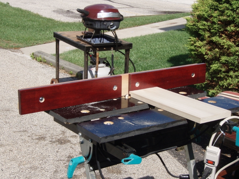

I love Doug fir, I can make it look like antique aged mahogany. Made my router table fence from it and dyed and stained it to look like it.
P6020091 (800x600).jpg (500.53 KiB) Viewed 2513 times
Very nice! Nice finish! I am glad I am not the only one on Douglas Fir. It is cheap, available and easy to work. I don't like the splintery property, but all in all, a beautiful wood. My father in Law used a lot of it as well as oak in his cabinets.
