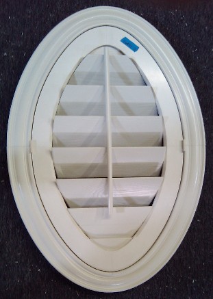

Everything I build here is a one off custom. Very few jobs have more than one arched window opening the same because sheetrock work is all over the place.
I was thinking of covering the platen much like a handheld with a replaceable sheet. This all depends on what I find.

Here's a shot of what I'm working on, the sander I need for the panels oval rail.
