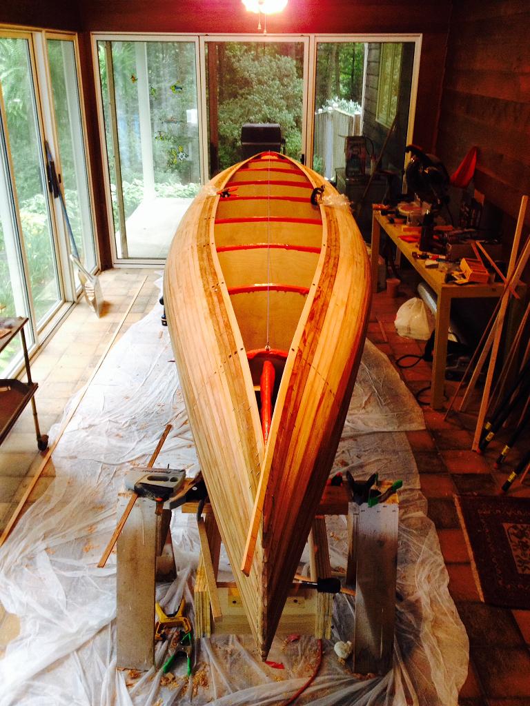

algale
Posts: 4841
Almost over the stems
Post by algale »
The Slow Boat is really living up to its name! Now I've got to stop and mill some more strips. I grossly underestimated how many I would need. It has led to using strips of a variety of colors as the lumberyard ran out of the dark board western red cedar I started with. I try to keep them roughly matched on both sides. Let's just call it "artsy"
[ATTACH]25968[/ATTACH]
"Wild Bad Bob"
Posts: 1065
Joined: Fri Mar 28, 2014 2:03 pm
Location: Germantown, Wi
Post by "Wild Bad Bob" »
Variety is the spice of life!!! Looks great!!! Looks like they will be below the water line anyway.
I dont know, Eustace and a friend put one together in a long day on Mountain Men last year, and that included cutting the strips. What a joke of a TV series.
shipwright
Posts: 1165
Post by shipwright »
Looking much better than some of the previous shots. It should be a piece of cake from here on in.
Good work.
