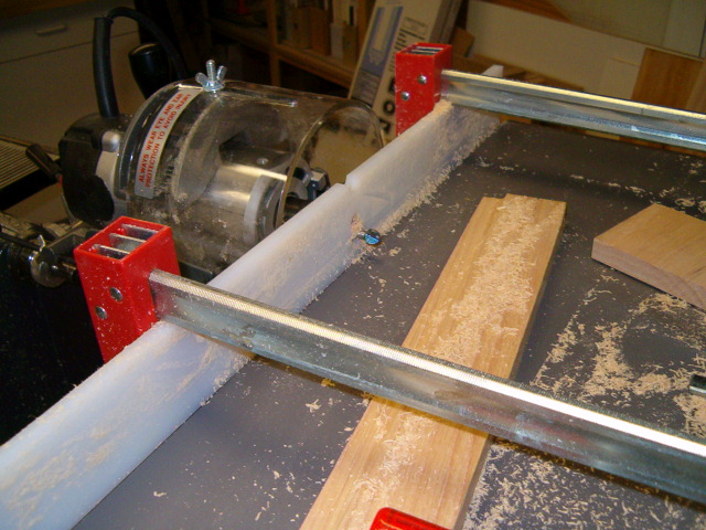

Now I've got to call BUNK!! to the claims that you need higher HP routers to make raised panels. There are always more than one way to skin a cat and more than one way to rout raised panels. In one case I used a 1/4" shafted core box bit to make the panels. (pix below- at least the set-up) Some bit manufacturers, noting the dangers involved with the larger diameter bits, made vertical panel raising bits. These are narrow, longer bits that allow using smaller HP routers.
P,S. This operation was done before Nick showed us how to make a sliding table. If I do this again the bit will be below the table in the slot of the sliding table where it should be. In this operation the clamps are to allow for the hold-down bar.
[ATTACH]1156[/ATTACH]

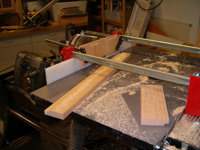

Hi Rick! You are right on! (usually are!) I really love my OPR, but there is that one thing! - - When it is in use, other Mark V functions are not immediately available for use. The exception being; horizontal positioning of the OPR and use of the jointer, bandsaw, belt sander at the other end. This gives some slack in the OPR's ability to be used with other functions. That said, most of us are hobbyists and really don't have the need for quick movement between machines. This goes back to the old discussions of what is best, multiple tools or a single Mark V.

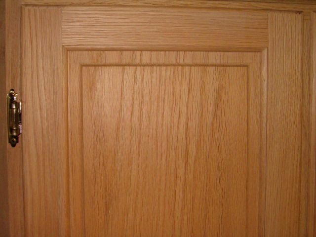

As an addendum to post # 24 Thought I'd add a couple of photos showing the resulting raised panel and the bit used to make it. Once again, a lower powered router will work!
The horizontal positioning of the OPR is more clearly seen in a third pix. There is an ability to still use the SPTs with the headstock.
The first pix shows the 1/2" core box bit with the hold down removed - the second shows one of the raised panels.
[ATTACH]1158[/ATTACH]
[ATTACH]1157[/ATTACH]

Charlese, did you have the router bit above the surface of the table? It's hard to tell exactly where the router bit is from the pictures as they are not close ups. My concern is safety. My impression after watching Sawdust Session was that the router bit should be under the surface of the table with the cutting edge exposed, for safety, so the work piece doesn't get caught and thrown back.
Jim in Tucson
