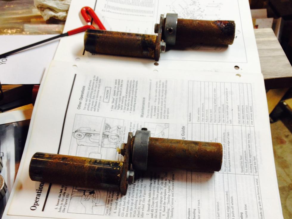

So, I took the tubes out of the bandsaw and I can see these are indeed the special band saw eccentric tubes (for use with the aluminum table so you can go vertical).
[ATTACH]26687[/ATTACH]
The PO added the stop collars. Everything is so rusty I can't get the stop collars to slide off. So into an Evaporust bath.
Also, checking my vintage model, it appears the single autotrack bearing was standard equipment on a band saw of this vintage. I will be upgrading it eventually.

I ended up getting the table inserts from peachtree. Had to thin it down to flush with a card scraper.
That's the only source I've seen.

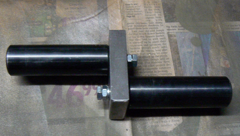

P.S. I recommend replacing that thin bar stock with something much thicker.

I do have a jig saw insert and will try it out. As for the tubes, I don't have any pieces of steel like that hanging around and if I did I'm not sure I would have the capability to cut and drill it.JPG wrote:I believe the insert is the same as the cast iron jig saw. Still scarce, but if you have the jig saw. . .!

What do you think I used to cut/drill what was in the pix?:Dalgale wrote:I do have a jig saw insert and will try it out. As for the tubes, I don't have any pieces of steel like that hanging around and if I did I'm not sure I would have the capability to cut and drill it.
Called a rotozip and a Goldie!:D
algale wrote:Not sure I know what a Rotozip is. Where's the stock from?
Think abrasive cut off wheel(very thin, but also very small)
Steel supplier. Common bar stock. Not cheap, but one might get lucky and get a cutoff.
I have used an 8" abrasive cutoff wheel in the Goldie on occasion, but it is messy and wastes too much material(think kerf). Sure is pretty when cutting though!:D Must . hold . work . piece . very . ' securely!
Then there is that hand tool called a hack saw.
http://www.rotozip.com/en-us/Pages/Rotozip.aspx
